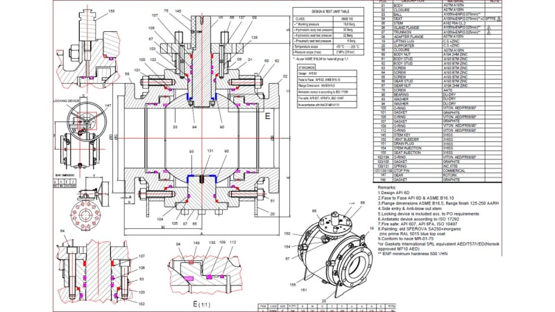

Hi All
I aviation gas being a "dry" fluid, I suspect it is affecting the seal & potentially the seat.
CG-PTFE, first time I encounter this specific product.
Unfortunately, the valve specifications for this company is not as comprehensive. Pretty much the same across for many fuel type.
I have attached GA drawing.
There are two injection points. Do you or can you inject grease into them?
If I've read this right there is a bearing surface also on the top of the ball?
Can you attach the drawing as it is difficult to read the fine details when you post in images.
I would tend to agree with BCD, the material selection should be suitable for the application unless there is some peculiar additive in the fuel. One of the causes for increasing operational torque in trunnion mounted ball valves is the acculuation of foreign matter betweent the back of the seat carrier (04) and the body/tail piece (02), or in the body cavity itself (i.e. between the two seats where the ball sits). If the seats cannot move, piston-like, on and off the ball, the friction between the seat and the ball will steadily increase, with a commensurate increase in the required torque to operate. I apprecaite that you metion a strainer in the system, but even a fine silt can cause this issue over sufficient time.
With respect ot LittleInch's comment, there are specific valve seat lubricants on the market that are designed to be injected into the seat seal area through the Energency Seat Sealant ports, but I would rule the issue of jammed seats out before going down that route. Irrespective, I would use these before a generic grease.
Good advise above. The shaft injection points are first for sure to try, but if all you're doing is replacing the valve and not trying to dismantle it to see whether you can clean it or see where wear is happening then there are many potential areas here that could be the cause. The bearing surfaces seem to be "Du dry" ? what is this?
I'm pretty certain this is the problem. The valve has DU trunnion bearings. DU are metal backed bearings with a bronze, PTFE and lead liner. They are made by Garlock. In this design, the bearings are rather small relative to the pressure force they need to carry. They are not going to last very many cycles. Once the upper trunnion bearing wears, pressure force will side load the stem and it will start to gall against the bore it is turning in. Galling will give you the jerky motion you are observing.
