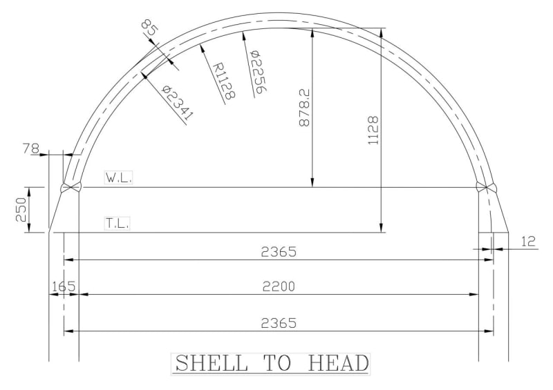

I take the connection of shell to flat cover as an example to show my idea,
a) Considering the reinforcement effect at the transition connection by the thick cover, it requests that area B > area A, so that get the 'average stress' at the slope transition is not larger that the hoope stress in the cylinder wall.
b) the maximum longitudinal stress at the small end of the transition shall not be larger that the longitudinal stress at the cylinder wall (pr/4t).
If the above 'a' and 'b' are satidfied, I think that may allow the thcinkness at the small end of transition being smaller than cylinders shell thickness, but not more than 1/2 of cylinder thickness.

1, The transition way of slope at the end of cylinder is only to make a smooth transition to reduce the centerline offset between the thicknesses of spherical head and the cylinder wall to reduce the discontinuity stress. But the slope transition is the true cylinder shape in ID.
2, Code never say that the slope transition portion at the end of cylinder to spherical head shall be considered as spherical head, especially for the determination of the transition wall thickness subjected to membrane stress. The transition is the cylinder shape thus the thickness of the transition shall use the formula of cylinder thickness, but not the formula of spherical head thickness.
3, As for the discontinuity stress here, Design by Rule is only to calculate/analyze pressure parts individually based on primary membrane stress and does not give the discontinued stress analysis at the connection, such as head to shall, flange to shell, flat cover to shell, and cone to shell. It is because that the discontinued stress is localized around the range of 2.5 sqrt(rt) and self-limited for toughness material (YS/TS is around 0.65 for SA516Gr70). And UG-23 (c) states that the discontinuity stress has considered into the allowable stress.
4. Even if it is not from a mechanical point of view, in fabrication view, you would not be able to get the spherical head with such shape of the transition. The transition is made from cylinder shell with a sloped shape in outside. See W.L and T.L of the transition in the attached

It doesn't matter where the weld is located, and vessels don't require a weld seam, except where necessitated by fabrication considerations. Likewise, the fact that the internal transition is typically straight/parallel to the cylinder ID, doesn't have any relevance to the design or definitions.
You design the hemisphere using PD/4t, which is a half sphere between tangent lines. Then you design the cylinder between tangent lines based on PD/2t. Now you add material to create this transition without reducing the thickness of any part below the code required thickness. This requires adding thickness to the head to form the transition. Logically you place the weld at the small end of the transition, which makes a thick cylindrical section with a taper at the end and a thin section with a spherical profile.
If you refer to UW-13.1 you can see the dotted line of the head extending to the tangent line. The diagram also shows material being added to the thinner of the parts joined. Now refer to UW-13(b)(3) and the extract provided below:
UW-13(b)(3) said:
When the transition is formed by removing material from the thicker section, the minimum thickness of that section, after the material is removed, shall not be less than that required by UG-23(c).
Even though a centreline offset is avoided wherever possible, this type of discontinuity stress is permitted and accepted by the code as stated under UG-23(c). Removing material below the code required thickness is not considered a discontinuity stress. This approach is consistent with fundamental theory and doesn't require any dispensations provided by specific diagrams (if available).

A priori of UG-23(c) for discontinuity stresses is that the general primary membrane stress limits are not exceeded. The proposed approach didn't meet this requirement.
There is no such thing as a tapered cylinder hoop stress limit. As discussed above, you have a hemispherical head and a cylindrical shell, which need to comply with the general membrane stress limits. Removing material from the cylinder to create the tapered transition violates this requirement, therefore, the transition is added to the head (not a cylinder). Code references were provided above.
The code theory is based the equilibrium model, whereby you can develop free body diagrams for each pressure component, with suitable boundary conditions, and determine the associated stresses and reactions from the applied loads. The allowable stress limits are general membrane and primary bending, consistent with lower bound limit load theory. When you assemble the components, interaction and displacement continuity develops secondary stresses and local membrane stresses. So your discussion of the 'assembled' stress at the small end does not fall under the general membrane limit. This is a simplification and is gets more complicated when you look at splitting primary and secondary stresses in detail, but any part with a general membrane stress limit should still be calculated by hand (free bodies), independent of the adjoining component.
Essentially you need to rethink the tapered cylinder concept, additional reinforcing is added to the thinner part to compensate for discontinuity stresses. For the flange transition proposed, a higher strength pup piece would be required to match the flange small end thickness requirement. Around the flange small end there is additional hoop stress associated with flange bending, so introducing additional discontinuity stresses would not be recommended.
