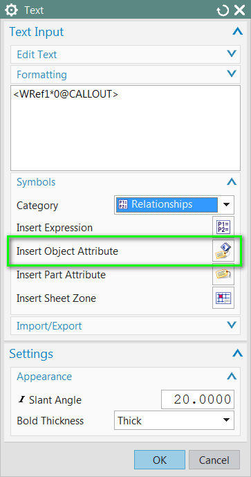

Try the following...<W$1*0@REPERE>
the 1*0 is determining how many characters are displayed after the decimal point
Also when you add the Balloon (not bubble :) ) and select the reference to your expression, you need to select the object attribute as the reference. (NX will ask you to select the component and from there which attribute)
