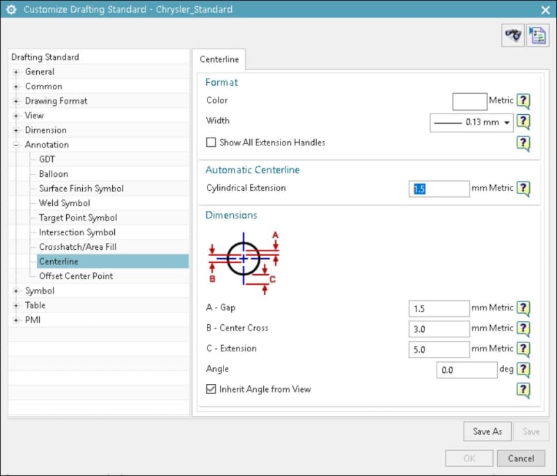

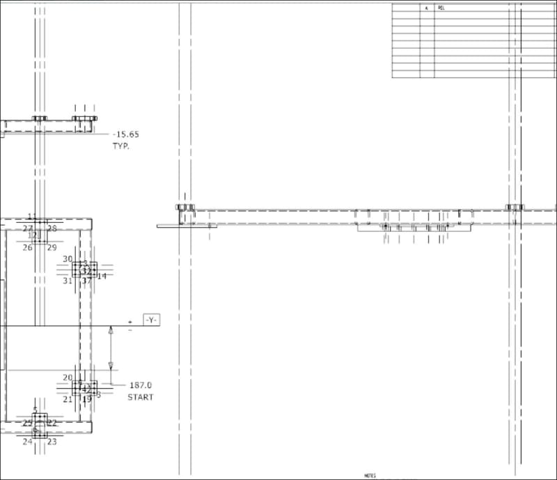

Good Morning to All,
I have been facing a weird issue since the start of the day today. The Automatic 3D Centerline on the Projected view is coming out to be way long as shown in the below images. I checked my customer default settings and I do not find any issues there. I have attached images in the below link. Has someone in this group faced a similar issue?
Thanks,
Amitabh
Are you using a template for the drawing? If so, templates override Customer Defaults and the settings need to be changed in the template file itself.
If only some of the centerlines are longer than others then I'd start looking into how the views were projected and if that checks out then there is something odd going on with your geometry. Also, you may have to adjust the view tolerance a bit if it's getting overly large/high.

I wonder if there is a conflict here between inches and millimeters
