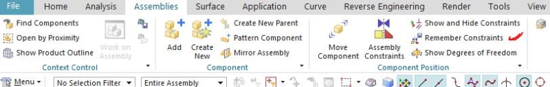

Hi all!
is it possible to create UDF component or component of Reuse Library add autoconstraint for positioning component in assembly?
Thanks!
Don't know whether this is what exactly you are asking, You can use remember constraints option in assembly to easily position the component while adding into the assembly.
