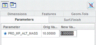

Andy,
I had this same issue with masses added twice. The solution is to make the mass a flexible parameter of the component. Details follow:
Open the part and set your part mass properties to "Geometry and Parameters".
Then manually set the actual mass and other properties.
You can then go back to your assembly and add the mass as a flexible parameter of some components, and set to zero.
Then, when you do mass properties on the assembly, be sure to choose "Assigned" instead of "computed".
Good luck.
