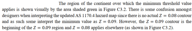

I'm glad to see that I'm not crazy and that the seismic hazard maps ARE contour maps. I still see engineers and online resources failing to interpret a contour map properly.
My issue (a little pedantic) is their approach in this update to remove the confusion actually adds to the confusion. By marking 0.08 low points on the contour map in inconsistence places it gives false and misleading information. If 0.08 is the minimum they need the 0.08 contour on the map!
EDIT: I suppose I should spend less time complaining here and more time commenting on the draft standard. [banghead]
I actually think that a shaded area would make it very clear where it is 0.8 so people don't waste time trying to read different contour lines. If the site is in the green area, it's 0.08, if it's elsewhere, then it should be fairly easy to tell because the contours will actually be there. H
Oh I agree! I don't know why they didn't include a shaded area in the actual standard.
