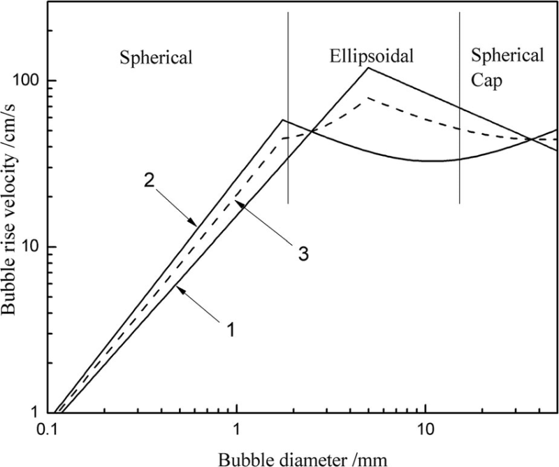

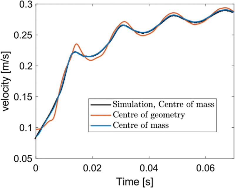

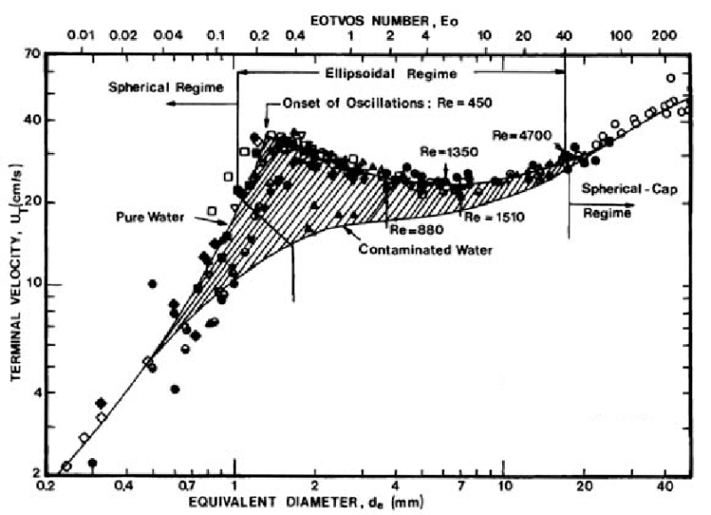

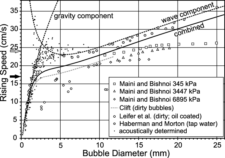

Bubble flow velocities.
Interesting charts of terminal bubble velocities in a watery solution.
I just knew somebody was going to ask that question one day.
They pretty much limit out at 1 m/s, which should usually be your minimum pipeline fluid velocity anyway. 1 m/s minimum to 3m/s maximum.

And a slide presentation of where I found the last chart attached.
Depend son the angle of the pipe and the direction of flow of the bubbles.
So a flat pipe or one going only say 45 degrees down doesn't need so much flow.
There have been a lot of papers and experiments and it might be a bit more than 1m/sec, but its in the right ball park.
see attached and on the next post
