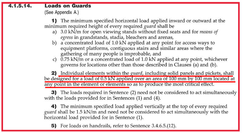

dik - Are you saying the Canadian building code requires 51 plf, instead of the IBC's 50 plf? Are you saying you would apply a total of 51plf x 12'10" = 650 lbs? Note in phamEng's original post, 12'10" was the run of the railing.
Ron - Your position is logical, but I recall reading otherwise in the IBC. I'll dig into it tomorrow and see what I find.
It's from the metric conversion... actually 51.1 and a bit.

NBCC specifically excludes concurrent loading.
