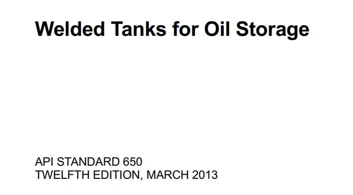

can anyone tell me Api650 is a design code or standard? please answer with reference.
thank you in advanced
It's A STANDARD
That's what it says on the front cover.....

Well this is what is says on the front cover....
And in section 1 - scope etc all sections start "This standard....."

Yes there are rules to follow IF you want the end design to be in compliance with the Standard. That doesn't make it a code.
The two are very similar and interchangeable - like I showed above ASME B 31.4 for example is both a design code and also an American standard. So they can be both at the same time. Tell them that the next time they ask... Look in the introduction of section of B32.4 for your reference.
API 650 is not "mandatory" as in you MUST build ALL vertical cylindrical atmospheric storage tanks to API 650, unless the legislation in the country you are building this says so. It is a defacto standard in the oil industry for large tanks, but many similar smaller tanks are built to other design standards and many not built to any standard at all, especially smaller tanks.
Legislation trumps everything, but is not universal around the world. That's why you need to know what the legislation is first and foremost. Then if allowed you can choose your design code and your standards. Many countries are not prescriptive about what you need to use and just require you to use something which is recognised and creates a low risk design.
I don't believe there is a hard and fast definition of when some document becomes a "code" and when it is a "standard", but in general a design "code" tends to have more about how to design something and has guidance in many parts, whereas a "standard" tends to be about how to design and construct a particular "thing", like a tank or a meter or a pump. API in particular seem to use "standard" to define their documents, but ASME uses "Code" a lot more, but still uses "standard" to define how components such as flanges are designed and manufactured.
