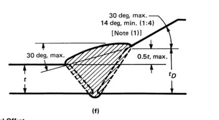

Figure I-5 as below is the code reference for how to weld different thicknesses. For flanges the ID of the flange should be the ID of the pipe.
This might be where the 4:1 ratio appears?
Also note the 0.5t max difference. X52 to A105 is about the max difference in stress you're going to find acceptable.
That's the only place I've ever seen the 1to 4 ratio, not that ever needed to search for any other reference.

Having gone through the MSS-SP-44 Cl. 5.3 Hub Design & 5.4 Welding End, its clear to have same pipe & the flange IDs.
Here in case, Figure 2'Bevel Detail for Wall Thickness(T),22mm (0.88in.)or Less' is the fit-up guidance we are going to adopt.

I think we have missed the point where you can calculate the require thickness of the A105 material and if this less that the thickness of the pipe then you can weld the A105 flange in.
eg if the X52 pipe is XS (12.7mm), The required wall thickness, at design pressure, of the A105 flange end 11.5mm then you can weld XS pipe to XS flange.
One condition, the stress analysis will need to redone with the lower strength material at the pipe to flange weld.
If the A105 flange end needs to be thicker than the pipe then an inside tapper does not work, you need a thick A52 pup, as above.
So long as the thickness of the flange is not more than 50% thicker than the pipe thickness then you can make up the difference in the weld on the outside.
See the diagram I posted above.
It's much better to maintain a constant ID, especially in pipelines.
