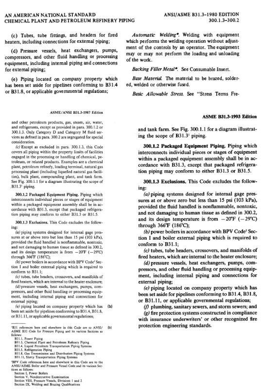

Hi all.
In the API 2510 standard, section 8 indicates that: The pipes of the facilities covered in this standard must comply with the provisions of ASME B31.3; with the exception that the pipe that falls below the exclusion provided for in section 300.1.3 (e) of ASME B31.3 must be constructed in accordance with the provisions of ASME B31.4.
However, in ASME B31.3 I only find the numeral 300.1.3 until subsection (d). Someone knows in what version of the standard or where I can find the aforementioned subsection 300.1.3 (e) that indicates the API.
In advance thanks for the help.
I couldn't trace it but it must be pre 1996 (!)

If anyone have a version prior to 1996 of ASME B31.3, which can verify if in that version there is the famous section 300.1.3 (e) mentioned in API 2510, it would be very helpful.
Thanks in advance
I have a few pre-1996 versions. I’ll check Monday when I’m at work again
Sorry, no ref on API 2520. Here are a few screenshots of the applicable sections form around that era
