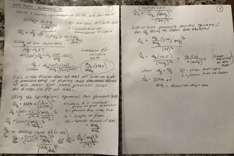

In the attached I first wrote down the API2000 equation which for this equation the pressure and temperature of the vaporized is considered at standard conditions per API discussion.
Then I determine an equation to express the SCFM of a gas at STP using the ideal gas equation.
Then I determed for same piping pressure drop what quantity of air flow is equivalent to a quantity of gas flow using the spitzglass equation
Then I substituted the SCFM of gas per the ideal gas equation into the spitzglass equation.
The result was the same equation of API2000.

The conversion is the equation shown in the bottom right corner of my calculation of sheet 1.
Qa = Qg (MWg)0.5/(29)0.5
Note that the conversion gives you the amount of gas flow to produce the same amount of pressure drop when relieving throuh a vent rated in pressure drop at SCFH of air.
Now for a blanketed tank with gas then on filling with gas outflow, this would be used to determine pressure build-up in tank due to pressure drop across vent device with gas flowing out of it. However for in breathing due to liquid movement out then this conversion I don't think applies since inbreating is not throuh the vent. In this case you would just need to replace an equal SCFM of air with gas to keep pressure in tank from reducing, since a cu ft of volume is same regardless of gas.
