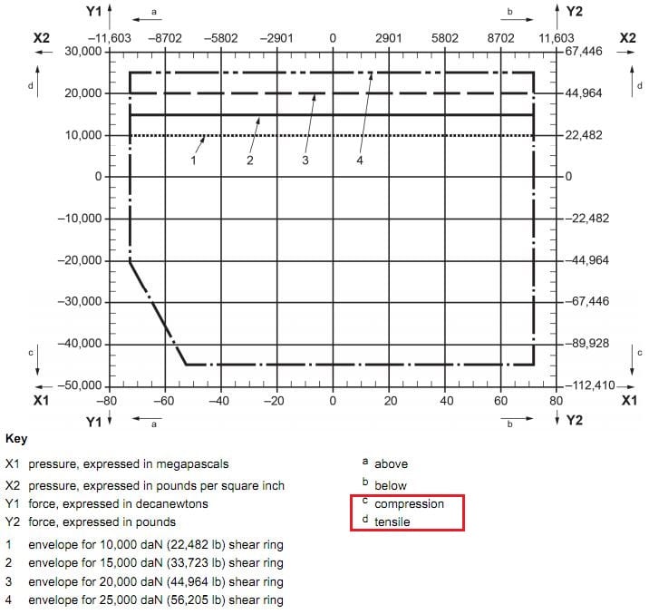

Hello guys,
Fast question to someone that mastery on API 11D1 due i have no idead about this definition.
What is the clear definition of Tensile of Compression ?
Before many thanks
