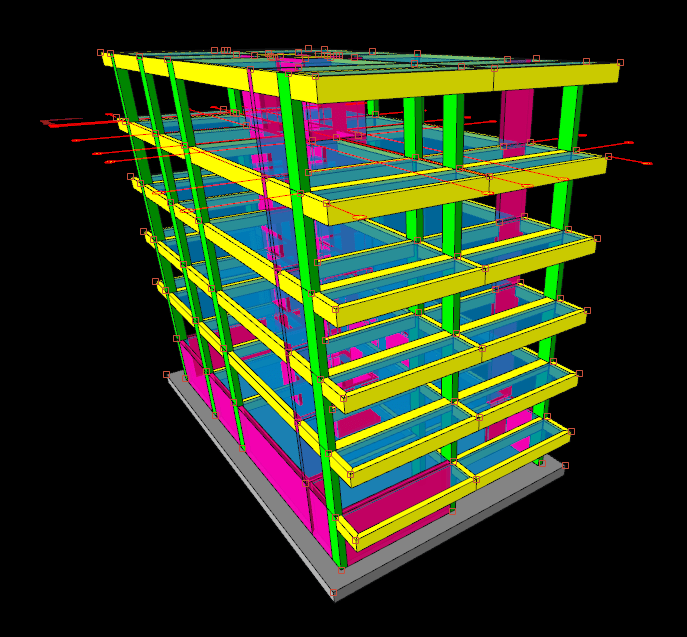

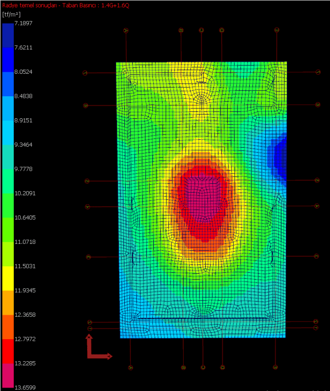

In normal cases i would go with Φu=0 and Cu= Something (From that graph with Plasticity Index f1 and N Value [or from lab tests]) because when earthquake hits the building (Photo 1 shows the building) my mat foundation will lean on the opposite direction and build apreessure to the clay (I made them put 30 cm of gravel fill under foundation) and this event happens for maximum of 25 seconds therefore clay cannot be drained so i have to use Cu (su). But the civil engineer of "city hall" don't understand this and he want me to calculate long term bearing capacitcy and compare it with building's average pressure(Photo 2 shows average pressure under mat footing).

Your structure has an applied pressure of ~130kPa (13.65 ton/m2). Determine you phi' from your atterberg data and ignore c'.

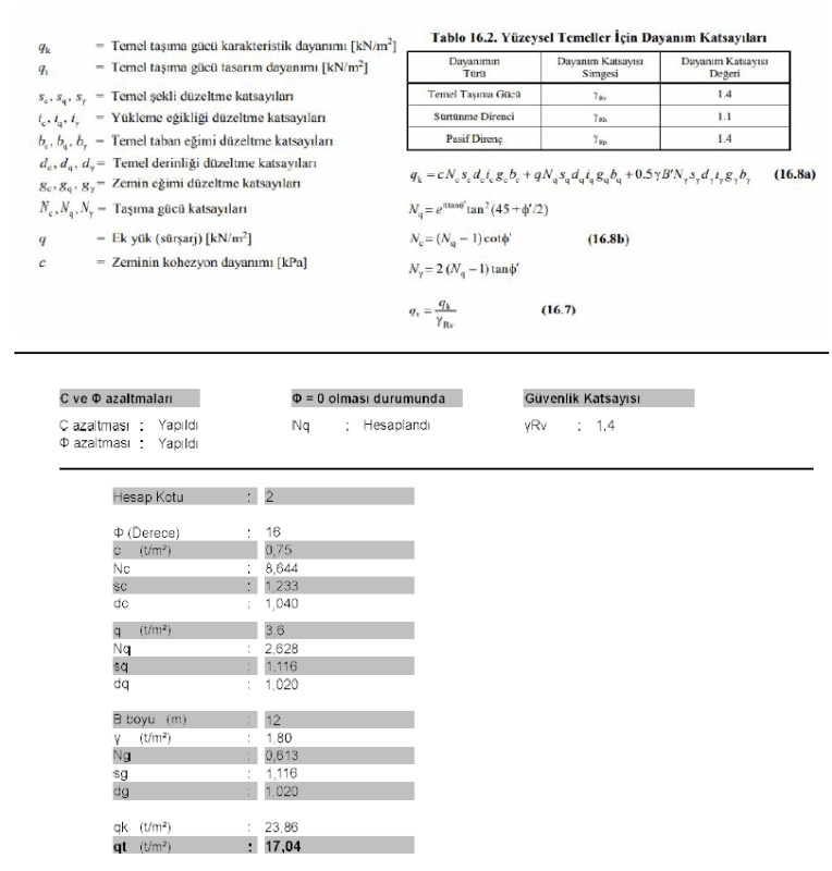

After we speak i did calculations like you told me and i am more conservative i guess so i get phi of 16 degrees(phi'=2/3phi) and
for c i took a very little value (0,75 t/m² and aplied c'=2/3c so C'=0,5 t/m²)- calculate the "Long Term" (Photo-1)

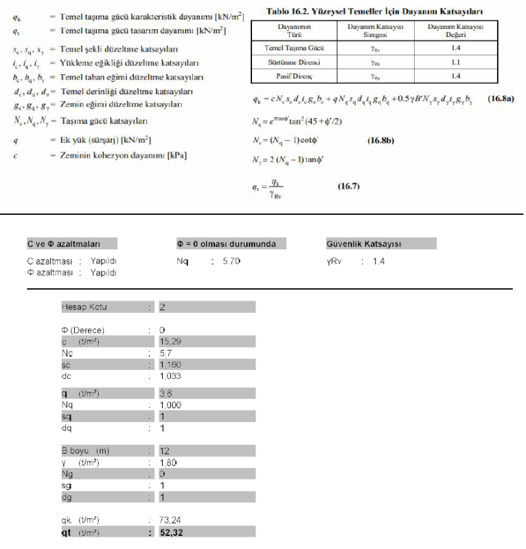

Then for short term capacity i took phi=0 and Cu=15,29 t/m² (150 kN/m²) and calculate for "Short Term" (Photo - 2)
Photos have foreign language (Turkish) but there is formulas all same.
