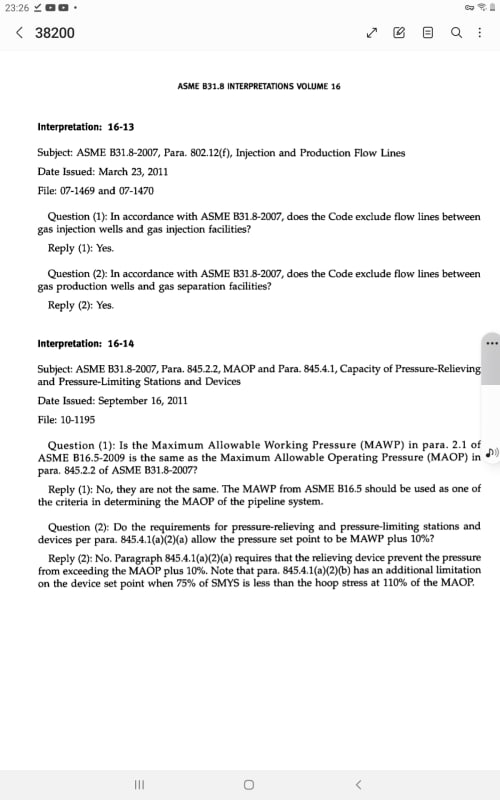

ANSI/ASME B31.8 para 802.1 (b)(6) State that this code does not apply to flow lines Between wellhead and trap or separator, What is the intent of this exclusion ?
IF B31.8 is not appropriate code for flow line design, then what is?

I don't see how the interpretation buggered up anything.
That appears to be consistent with both of our recommendations to use B31.3 for flowlines, as B31.8 does exclude flow injection lines, between inj fac & inj wells and it also excludes flow lines between production wells and gas separation facilities, so use B31.3 for all flow and injection lines. The CFRs only make a change when they become pipelines, by virtue of entering "PHMSA pipeline space". As I said above, IN USA, B31.8 must be used if the flow line crosses a road, or enters public lands, or a production facility, as then the flow line ends and it becomes a transportation pipeline. It has entered the pipeline safety act territory, so it must conform to pipeline safety, requirements, class location factors, inspection and reporting requirements.
Let's check and make sure that the newer editions of ASME B31.8 have in fact remained consistent with that 2007/11 interpretation, or have been additionally clarified. Or maybe they now include public safety space criteria. I don't have the latest edition.

The latest one I have is 2018 and that still doesn't over flowlines form the well.
Thanks. I didn't think it would change, but nice to know that it did not.
