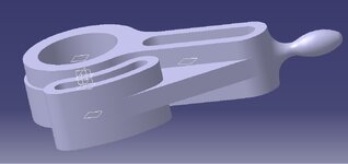

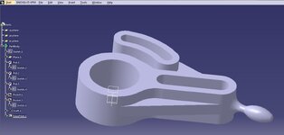

Now I'm not sure if this was the best strategy but... to build it I've used two sketches.
With sketch 1 I created a "central" pad (pic 1) and on its upper face I created sketch 2, which was used to create a second pad extruded in two directions (pic 2).
The first problem is that the second pad goes through the first. Catia didn't complaint but it doesn't seem the best solution.
Another problem is that both sketches have features in common. So, it creates duplicates.
Anyway, that part was constructed but I can't create a fillet connection the rev solid with the main body. I suspect that those 3 separate surfaces should be connected, since the midle one is not enough for the R20 fillet that should be there.

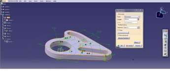

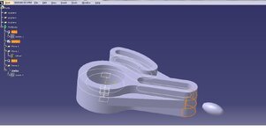

I'm having problems in creating the R20 fillet. As I said in a previous post, the part seems to be divided in three horizontal sections (pic 3) which seems to be the cause of the problems. Everytime the fillet radius goes beyond a certain value, it is formed outside of the central section causing the result shown in pic 4 (as well as a lot of error msgs).
Any sugestions?
Thanks in advance.

My guess is the R20 face is not exactly the same in PAD5, PAD6, and PAD7. Check the sketches and verify the radius is the same value, and the centers are the same also. (This is a good example of defining the R20 circle in one sketch, and then projecting it into the other sketch(s) so everything always matches.)
Yes, that was the root cause. Since some sketches had common features, I used copy & paste but it didn went well (I could confirm it by comparing the circles center point coordinates).
I didn't modify the complete sketches but projected one of the circles (those used to create the pads where the fillet was going to be constructed) on the other sketches and now the result was ok (pic 6). Take a look at pic 5 to see the mismatch between sketches.
