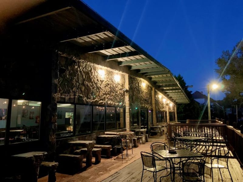

Could this have been the result of 'outdoor' spaces being used for guests which wasn't originally designed to hold so much live load? What I mean is, many restaurants are looking for outdoor dining and party spaces in buildings which were never designed with that in mind.

If you have a fully loaded parkade with vehicles parked side by side and end to end... you may have 20 psf live load. I'm not sure that design load is an issue. Judging from the size of those members it does not appear underdesigned... possibly a systemic connection failure would be my first 'kick at the cat', or a poor construction detail.

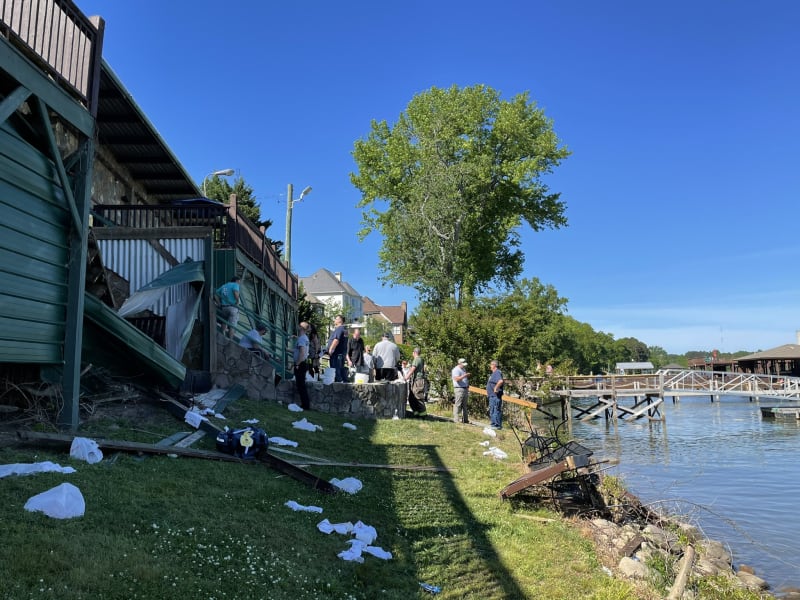

It looks like there might have been a midspan column that collapsed

Maybe prejudging from limited photographic evidence, but these things are almost always either from wood rot or inadequate connections. My bet on this one is connections. Probably no real engineering involved, just slapped up by good ol' boy self described carpenters.

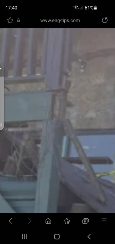

Those cross beans look like they were nailed into the end plate. Terrible design and whatever was holding up the deck in the wall side isn't there anymore
It must be so widespread a method. I've owned two houses, both which used the method. One I retrofitted bolted brackets to, and one which I left as it wasn't critical. There must be millions around the world done that way, including many that will fail at relatively small loads.
Not only that but the front plate rests on a little cut out held on by two nails....

Apparently a "group" gathered on the deck for pictures over looking the lake when it collapsed in the centre, so that rather weedy looking post may well have given up the unequal struggle or the end plates just came off it.

Looking at this photo it looks to me like the front plate attachment to the post was a small cut out into the post of maybe only 1" or 2" at most over a length of 2", held there by two nails or screws. So if say 15 people gathered next to the post then you're looking at upwards of 750 kg on each connection. Terrible design.
My guess is that the post/diagonals/'beam' all just fell over and away after the joist/beam connection failed. Looks like there were 3 nails into the end grain of each joist.
If the photo below comes thru w/ any resolution you can zoom in and see the nails bent over.
"40 people had fallen" and "They all congregated outside on the deck to take a group photo". Two bits says they were all grouped up, right at the handrail so that they'd get the beautiful lake in the background. Local overload, but also inadequate connections (toe-nails).
