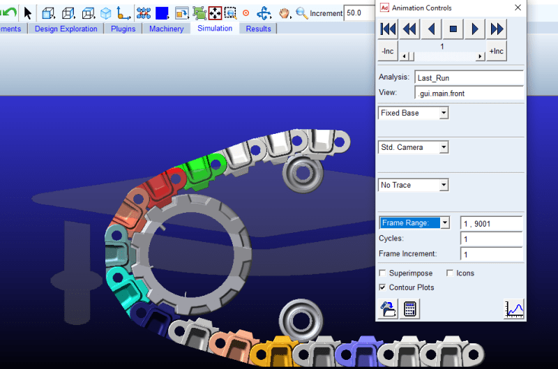

Hello Everyone,
I am using ADAMS student version for one of my task and I am facing a problem for past few days.

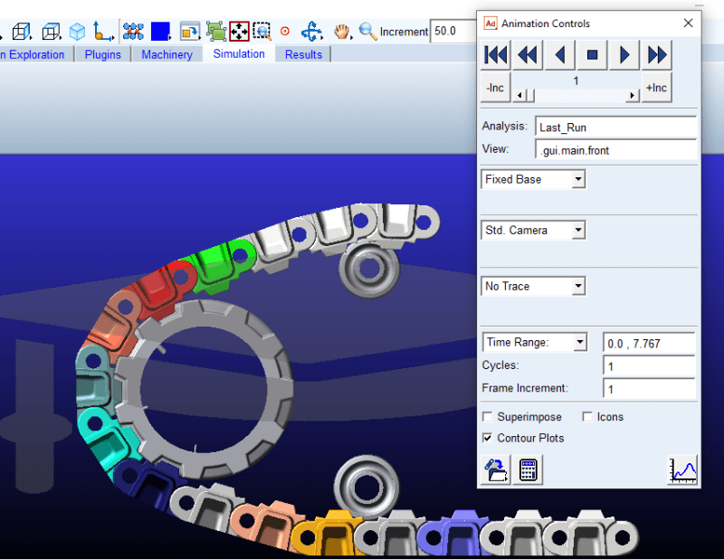

For whatever time duration I run my simulation the time covered in animation is always a bit less then the time defined in the simulation.

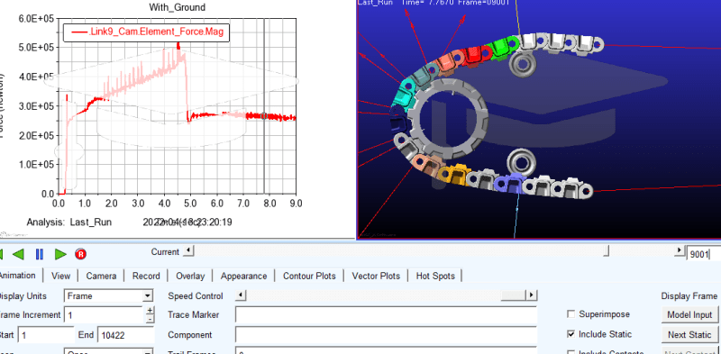

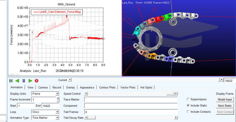

And when I am trying to track my plot through an animation beside it then the animation completes some duration before and plot is tracked uptill the full simulation duration.
Please refer to the pictures for more clarity. Here you can see that in animation control window the time range covered for animation duration is 7.767 seconds inspite of total simulation duration 9 seconds and this value is not changeable. Also number of frames are also reduced, actual number of frames should be 10422 but for animation only 9001 frames are covered.
I hope there could be some solution for my problem.
Thanks a lot in advance for any solution!

If you look in the msg file it'll tell you when the simulation stopped. My guess is that for some reason the plot is not being updated to your latest run and so you think it gets to 9.000 s but it really stops at 7.767
Try giving it a new name and then rerunning it.
