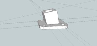

Good Day!
I am just starting with SW and did some of the beginner tutorials but i was trying to replicate this one. I did use sketchup and would like to concentrate on using SW.
its a simple base plate 3mm tall and a square on the top that is angled with a 9 mm hole.
Any tip/tutorial link that shows how to create an angled object on a flat surface? I tried to draw a square on the surface and use extrude but cant make it go on an angle.
Thanks so much!

two easy ways for you to choose:
1.Change the sketch plane
2.Specifies the direction of Extrude, and the End surface

Just create a plane at an angle somewhere offset from the base using Reference Geometry & build a sketch on it & then extrude up to body or surface. To create this you can also take the help of the link given below:
http://www.techsavvy.co.in/index.php/product3DCADSolidWorksStand
Moreover, if still you face any problem then please let us know as we are there to serve you round the clock.
