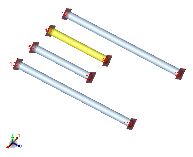

That's only true for perfect/ideal anchors, which Peng talks about in their book.
Even a quick model like the one attached shows this isn't true for real/imperfect anchors.
Element 10-20 is 5 ft long while Element 15-25 is 10 ft long. Both have perfect anchors and see the same loads as expected. Element 50-60 is 5 ft long and Element 100-110 is 10 ft long, but the "TO" node has imperfect anchors and their loads vary.
