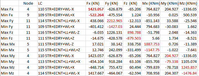

Im designing a Anchor bolt for skid base. There is a moment in the anchoring location.
How to convert the moments into tension force. I have attached the image. Please help.
This skid is not anchored to concrete. It will be mounted to another steel frame. Hence the anchoring point is not rigid in Y(Vertical) Due to this when there is a operational load base beam member will subject to some deflection. which will create moment. In analysis it is not pinned connection. It is fixed but with vertical spring constants.

Can beam it's sitting on support a 2000kNm torsion? No I am guessing? Then it's behaviour is close to a simple support in reality.
Something is wrong with your support assumptions if you are getting any moment (as torsion) into the supporting beam. If you don't believe us actually model the 4 support beams and you will see some small torsion in the supporting beam even with a 'fixed' end connection between the frame and the supporting beams. You will not have a 2000kNm moment at the support location.
The heavy moment is due to the column, equipment & mainly wind load on a vertical vessel above the skid. The vessel height is more than 10m. it is in the corner of the skid. The exact moment is 1887 KNm.

Anupriya123, is the moment actually the reaction? Or is it just the moment in the frame at the support.
If it is the reaction and you are getting a moment transferring to the supporting beam as a torsion, then something is wrong in your model. Please provide printouts of the moment, shear, reactions and deflections so we can understand your analysis you are relying on.
The drawing showing the location of those nodes on the model got dropped by the upload genie.
You appear to be fixing your frames for moment at all supports. This assumption is inconsistent with the detailing. Pin these supports, or explain why you think they have moment fixity at these locations?
I was really referring to providing the shear and moment diagrams, not just a list of numbers which we have no idea where they apply.
Or just design the bolts for 6000kN force if you don't think your support beams will rotate as per the graphic you provided.
