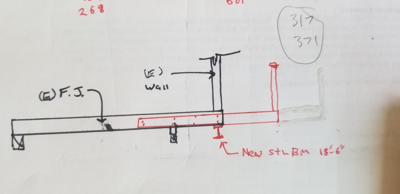

I am doing a residential project where there is an existing 2 story house and they are adding a new front balcony.
The existing floor joists cantilever 3.5ft and support the wall (roof) above.
Since this isn't the best condition I am adding a steel beam under the wall above so that I can cantilever new deck joists out for the new balcony. I am extending the new deck joists 7ft back into the existing floor framing and sistering them to the existing floor joists.
I am having problems correctly analyzing the reactions to the new steel beam.
Would the rxn at the new stl beam just be the entire fj/dj span with 3 simply supported rxns?
Partial framing plan attached

beav-eng, I have already sketched it but I am not 100% sure about the reactions.
I initially assumed that the reactions would be the fbd of the entire new & existing joist section with 3 rxn's.
The beam is 18'-6" it supports roof, floor and balcony. 40psf LL & 60psf LL for balcony. A wood bm works but it is 16" deep. Thats why I'm using steel.
Thanks Lex, see attached .jpg. Red is the new framing.
Which part are you unsure about? This FBD looks correct based on the plan you provided.
Haha, forget I asked....I had a major brain fart.
