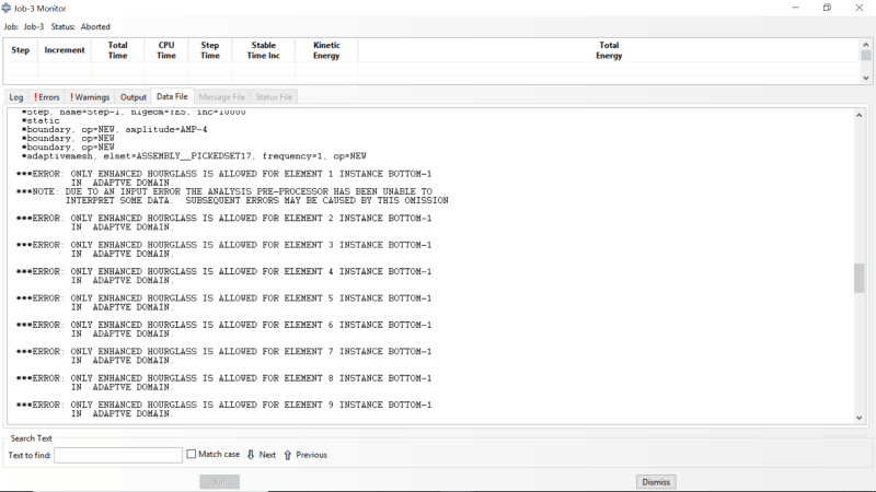

I was trying to do a reciprocating sliding motion simulation in Abaqus using static, general mode. When I turned on ALE mesh, the system threw an error:
"Analysis Input File Processor exited with an error."
It seems to work fine when ALE was turned off. I was using pressure load and displacement boundary condition in periodic form.
I kindly request your help to solve this issue.

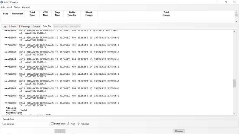

That's a generic error message. There should be more errors in the dat and msg files. Please search for them and paste them here. Or attach the dat and msg files.
So the actual error message is "Only enhanced hourglass is allowed for element ... instance ... in adaptive domain". Thus you should set Mesh --> Element Type --> Hourglass control: Enhanced
