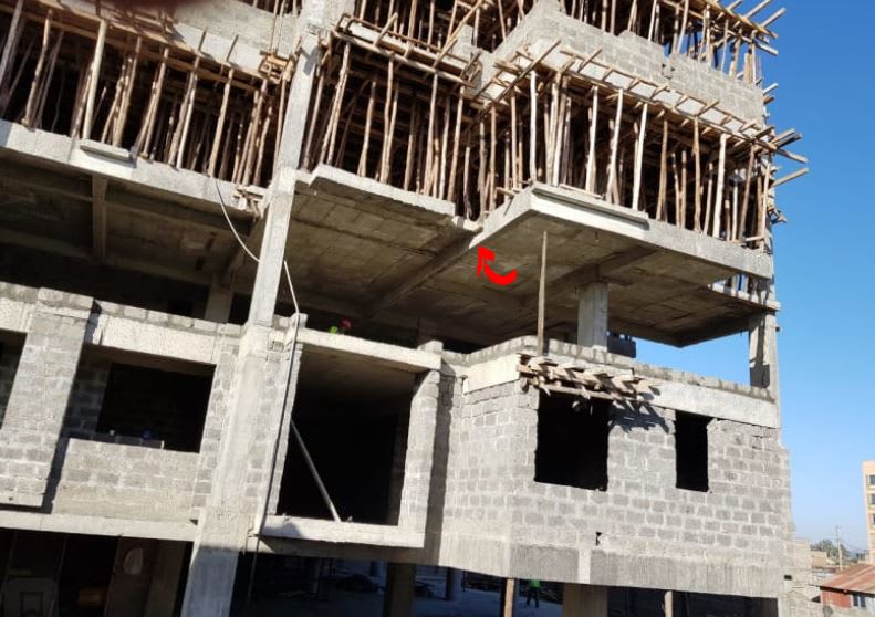

An interesting thing for me was that cantilevered beama

@azcats, very true about your post. But this building is different from the ones that keep collapsing, it has licensed engineer and has been approved for construction. I actually posted it here to see if there is an engineer who has done something similar to increase my knowledge

Is that a down-stand beam? where is it spanning to?
I am just as scared of what looks like wood temporary bracing that is older than me. The temporary shoring looks weak to me if it is wood. Bowed, out-of-plumb and in general too slender.

pretty sure the wood shoring isn't dimensional lumber, but raw timber poles. That's why they aren't looking perfect. They can take quite a beating before they are no longer functional
Assuming lateral bracing is adequate, the lick of my thumb and the feel of the wind on it tell me that shoring itself fine for gravity loading.
Though Im wondering if that slab may deflect, increase the floor height on the first shored level, then cause some poles to come loose and drop.
Can we get a rough sketch plan from OP? I’m really tempted to FE Model this for fun!!
To me, it looks like there are some missing columns here and there.
