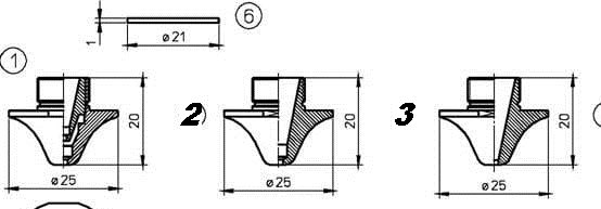

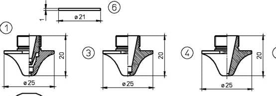

1=double nozzle (1 or 1.2 , 1.5 mm diameter for low pressure oxigen and 3 or 4 mm for high nitrogen cut)
2=nozzle for oxigen ( from 1 to 1.25)
3=conic (diameter from 1 to 4mm) i use 2mm diam. from 0.8 to 3mm SS(stainless steel) but in your case if the thickness of the material exceeds 3mm, try using the 2.5 nozzle with a pressure higher than 8 bar should be fine.

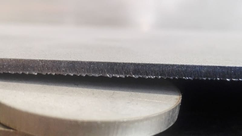

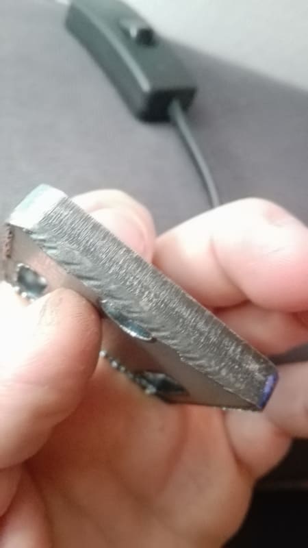

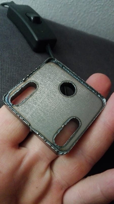

this is 2mm mild steel( but i had the same result with the 1.5mm), i try to cut with air at 5bar with 2mm nozzle but i cant remove the burr. i tried to go up and down with the focal but nothing happened.
i try speed from 3500 to 5800 and duty from 60 to 100 . Can anyone help me?
I try also 6 and 8 but i cant remove the burr.
The pics and the parametri are of the 6mm
Speed 1500mm/min 3kw 2khz 100duty 4 bar(my system cant go more 4,5 bar, i have to ask to my boss to fix the air system because now the air come from the main machine system and that cant go over 7bar, i think...) anyway, hnozzle 0.5, focus -3.0 . 7.5 lens and 4double nozzle. The pressure is too low??? Thanks
Try the focus setting alone. Also check whether FOCUS adjustment working properly. Execute FOCUS check program in a 1 or 2 mm sheet to check the setting

Thanks for the reply. I'm pretty sure that the focal length is moving in the right way (the machine works well). I want to clarify, these are the first tests that I carry out by cutting steel with air. however I will try the focal again to be sure. I still try to play with the focal length but if I remember correctly, on the 1.5mm MildS. I tried to go -3 points and + 3 points and there was no difference (below -3 or -4 it did not cut). generally the focal length is like cutting in nitrogen? as for example 0.0 (focal on the surface) for fine thicknesses (0.5-1.5) and for greater thicknesses about 2/3 below the surface? I apologize to everyone for my questions but here in my area there are not many laser workers (especially that I know personally)
