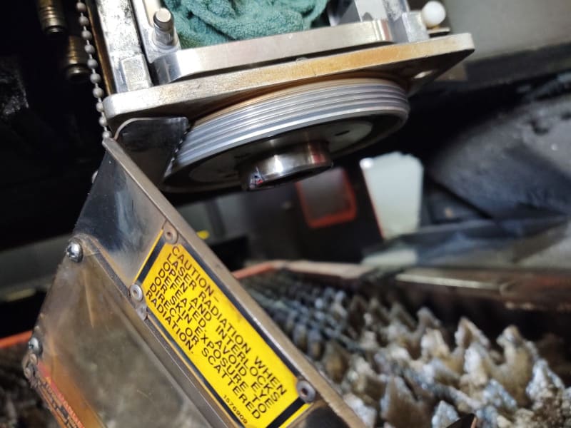

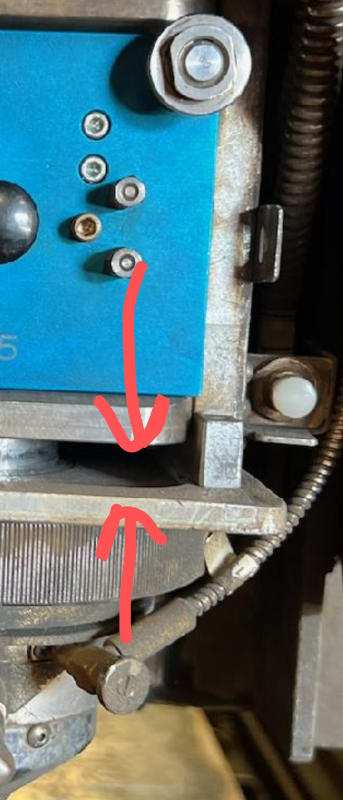

Hard to do with out pictures, but I'll try
On the NT, below the lense cartridge, on the cutting head, there is a machines aluminum plate
Below that plate is an opening that gets bigger and smaller depending on where the focus is at.
That gap has to be 3/4" . Used the hand wheel to move B to that position.

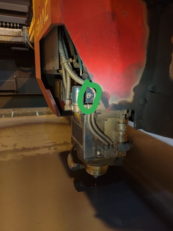

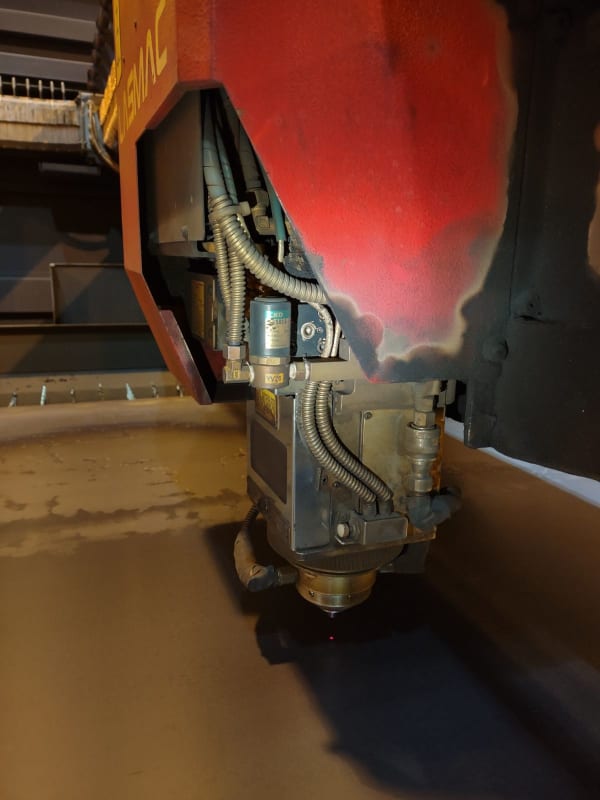

I like how it up loads two pictures.
It not my fault:)
The set screw / bolt is really just a cap.
Pull the cap and you'll see a place for a flat head screwdriver. Put the machine in E-STOP and turn the "screw" I'll u get a gap where the double pictures indicate. You don't have to manually drive it all the way, just till it gets unstuck.
Double check your focus position call out on your cutting page. Make sure it's is not a large value. It should be close to zero.

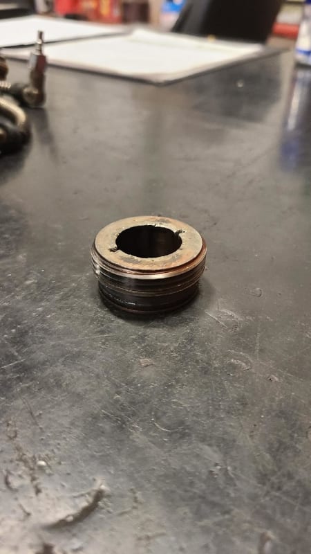

Take off the cone and see if the red anodized aperture is caused the binding.
Hi ,so I unlocked it. By removing the bottom plate where cone screws on .
