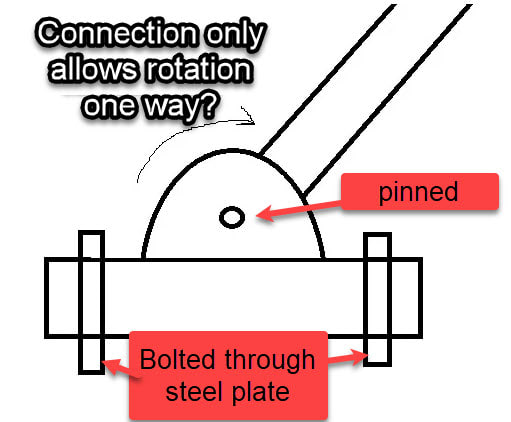

Am I right to think that this connection will only allow beam to rotate in one direction? 3
bojoka4052
Oct 8, 2021
108
When modelling this in a FEA software, should rotation only be allowed in one direction, for example x-direction, or two direction, x-and y axis?
If you use beam elements and want the part to rotate only in one plane then leave the rotation around the axis perpendicular to it as free. Other degrees of freedom will be fixed in this case.
It depends on the relative stiffnesses of the parts.
For example, if the vertical plates are flexible relative to the member, then the connection might behave more like a pin for bending about the horizontal axis perp to the pin. For that dof the plates would be bending about the weak axis.
Are we talking actual FEA, or just a 3D analysis program? Not the same thing, and the answer depends on which one you're using.
Not sure the difference, but modelling in a 3D analysis programme, say Abaqus CAE
The hinge at the figure allows rotation in one direction .. If the X and Y directions are selected on the plane, the hinge allows rotation on Z axis ..
So you are expected to model the hinge with releasing the rotation at Z axis ..

I modelled it to freely rotate around one axis since its hinged, and later saw that someone before me had let it rotate around two axes and was wondering if I had made a mistake, which I see now I did not.
