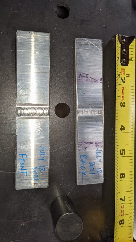

Amateur question. I have been bending my practice weld coupons around a small pipe, then bending tighter in a vice - just to check ductility.
Photos below are pre-bend and post-bend
Background:
Uphill, 3G
One-sided complete joint pen at butt joint (no gap)
6061, 1/8" thick
3/32" 5356 filler (roughly 2" of filler per 1" of weld)
3/32" tungsten with 16 to 17 cfh Argon, gas lens
About 115 amps, 75% electrode negative on Syncrowave
Most welds had full burnthru
No pulsing, relatively steady foot pedal, moderate SS wire brush cleaning prior
Coupons cut to approx 1" wide strips x 5" long
Some welds show very high ductility, but occasionally a weld fractures right at the heat affected zone ("HAZ"), without too much tension straining. Brittle.
I keep preparing to take my 3G test for AWS D1.2, but this is humbling. I would like to determine what are possible contributors. I'm not just the observer - I did the welding - very little difference between the welds - from prep to last puddle.
Any advice is welcome - but especially guys with lots of aluminum experience.
The alloy you have elected to weld is recognized as having rather poor properties in the "as welded" condition.
The mechanical properties, i.e., tensile and yield strength will be degraded by 40 to 50%. The ductility is about half of that of carbon steel and even that is degraded in the "as welded" condition.
The bend diameter is on the order of 16 times the base metal thickness. Compare that to 4 times the BM thickness for carbon steels. The bottom line is to use about a 2-inch bend diameter for 1/8-inch thick material. If you have a copy of D1.2, you can look up the exact diameter of the bending mandrel. By the way, when you do take the qualification test, make sure they are using a wrap-around testing machine, not a plunger and die machine. Good luck.
Welding generally overages the HAZ of the heat treatable aluminum alloys (6061). That simply means the alloying constituents that normally strengthen the alloy by clumping within the lattice, instead precipitate to the grain boundaries which weakens the base metal. That's rarely a good thing.
I almost forgot, DO NOT USE A WEAVE TECHNIQUE. Use stringers and as high a travel speed you can and still get the joint penetration you need. I typically cool the base metal between weld beads if a multiple bead technique is used. Keep the BM as cool as practical. Use a fan (no compressed air) to cool the material as quickly as possible. Clean wet rags will do the trick as well. Keep everything clean, including the stainless steel brush. Wire brush just before welding. Sheared edges should be draw filed with a vixen file to remove all the nooks and crannies that trap oxides.

Making multiple welds as you did and bending the coupon as you did is an assurance of weld cracking during bending plus some of your welds did not achieve full penetration. You should blend grind/rotary file the weld on the coupon and the coupon edges prior to bending.

Following up.
My welds are similar, but focused on code-level coupon preparation, and better wrap-bending (wheels with bearings; still a bit imperfect).
Also, minimized "time at temperature" per Armao, so just a single CJP per test mockup.
No cracks at face bend or backside bend for 2" diameter roller.
Aluminum is moody - really makes me appreciate mild steel.
Code compliance would require better bending.
6061 + 5356 = 6T for the Radius of the Mandrel, (1.5" for Diameter of 1/8" coupon thickness)
