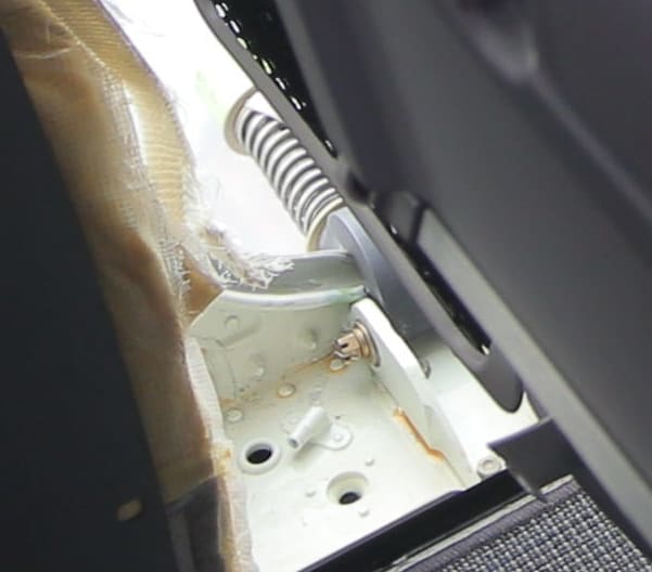

View of hinges. Due to minimal damage, it seems the door simply transitioned upwards and then opened.

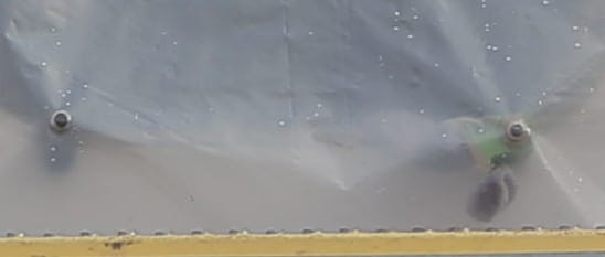

Loose bolt visible:
That's not one of the bolts that holds the plug in place when it's closed. That's the top of the tubular section that extends out from the hinge, with the green collar around it that should be attached to the plug (and was presumably torn off by the forces presented by the airflow when the plug popped open in flight). The bolt which prevents the plug opening would have gone through a radial hole in that collar and the tubular section of the hinge. The visible nut and washer there, as far as I can tell, is just to retain the plug on the tubular hinge section when it's fully open (otherwise it would just slide off).
There's a bit of a mystery around the "loose bolts" that keep being mentioned. Just being loose would not have allowed this incident to occur, they have to be completely missing/removed to allow the plug to move upwards and disengage the stop fittings/pads. If they are loose, but still in their correct bolt holes and have the cotter pin correctly in place, they should still function adequately to prevent the plug from opening. It's not clear exactly what is being communicated by the mention of loose bolts being found on other MAX 9s. It's probably not desirable to have them too loose, but shouldn't be imminently catastrophic; the plug does not depend on them being tight to keep it in place.
Edit: That's for the 4 bolts involved in opening and closing the plug, and the nut on the end of the tubular hinge extension. Obviously there are other bolts around, possibly related to the plug and frame, which could be critical if insufficiently torqued.

You are mostly correct Murph. No bolts keep the plug closed. The pads do not keep the plug closed, they act in the other direction and absorb negative pressure and minor distortion. The plug is held in place by the interference with the frame when in the lower position or perhaps by the roller pin and lower hinges. Two bolts in the pin/catch keep the plug on the track. The mystery is if those bolts went missing and how did the door move up against the force of air pressure? The roller pin and hinges are intact. The bolt in the photo seems completely backed-out, but perhaps the NTSB removed a dangling part and did this.

No, the stop pads very much do absorb positive cabin pressure (i.e. the normal case in flight). The "stop pads" on the frame are outboard, and the "stop fittings" on the plug are inboard when the plug is in the fully closed position, transmitting positive cabin pressure into the frame via the pads. The 4 bolts (2 through the guide fittings, blocking the pin; and 2 through the collar and tubular hinge extension) prevent the door sliding up vertically and disengaging the stop pads and fittings. The plug has to take a positive pressure delta of around 8 psi, and only around negative 0.5 psi (I'm not sure if those are the exact numbers for the MAX, but they should be a rough approximation).
The guide/roller pins and hinges are not really part of handling the positive pressure, although they might be what handles negative pressure.

I'm guessing that the loose bolts that were found by United are the bolts holding the door/plug lower hinge piece onto the door/plug frame. The part that slides up and down on the hinge tube. The upper bolts retaining the plug in position should still hold the plug in place if this was that case. That might be why the upper pin was found damaged.
The door must move upwards so that the side pins may clear the stop pads.
There is over-travel on the top guide to allow clearance tolerance so that the stop pins may safely clear the stop pads before dropping in behind the stop pads.
As the door crept upwards, as soon as the stop pins were clear of the stop pads, the door departed.
Th door had not yet lifted far enough for the guide pins to clear the guides so that the guides were damaged.
Four bolts is nice symmetry, but even one bolt should have prevented the door from moving upwards.

In one of the photos in this thread, there is one bolt at the bottom of the fitting that does not look tight.
