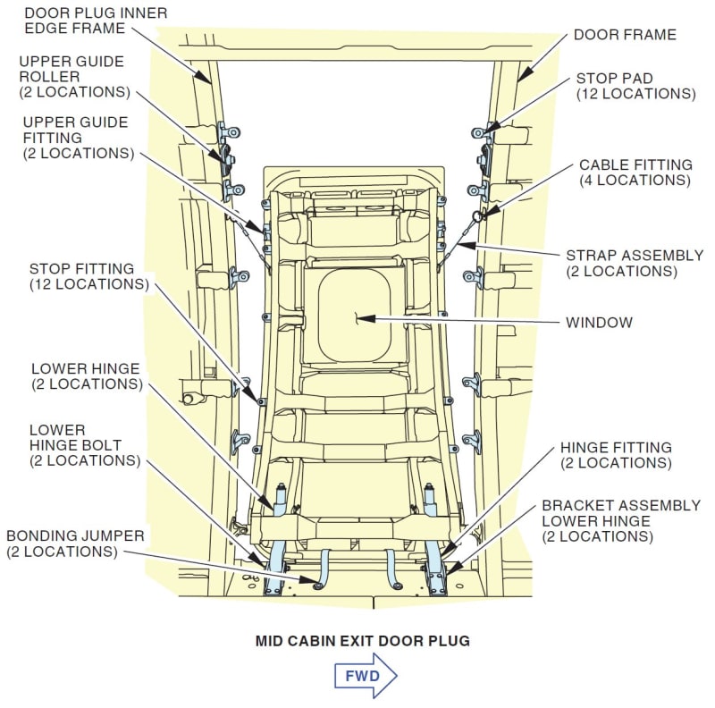

From the looks of the above diagram plus the picture of the location of the loose bolts found on the United jet, if the bolts fell out of the bottom hinges, that would effectively detach the springs from pushing the plug down into the upper guide fitting.
Without that spring tension, a jolt (like turbulence?) could cause the plug to pop up, clear the upper guide fittings, and open, perhaps?

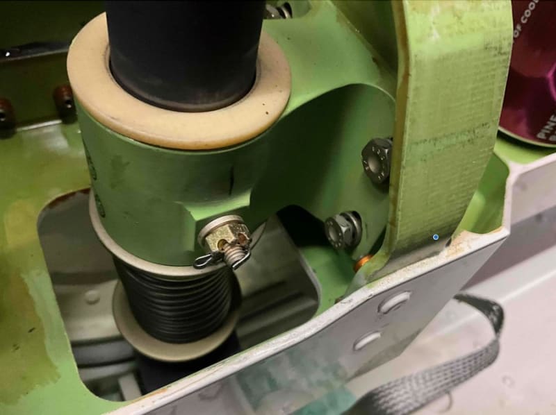

Here's a picture of one being inspected (posted on Facebook by Uretsky Aviation):
There is supposed to be 2 bolts in the upper roller guides to also prevent upward movement. They appear to be installed in the photo above.
The springs have the opposite function. They push the plug upwards and out of the upper guide fittings; i.e. they assist in opening the plug, by countering its weight and preventing it falling back down into the closed/locked position. The bolts prevent the door from moving upwards, by blocking the movement of the pins in the upper guide fittings and preventing it from sliding upwards on the tubular section of the hinge.

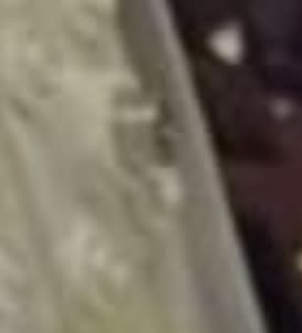

From the photo of the failed opening. It appears the failure occurred at the upper guide roller. The picture is poor, but it appears the castellated nut and the upper guide track fitting as well as the roller are intact.
The guide fitting and nut are not present in that photo, as far as I can see. It appears to be a photo of the open frame, showing only the guide pin. The guide fitting, bolt, and nut are all attached to the plug.

I don't understand the "stop pad" and "stop fittings", but I haven't seen a clear picture of them with a plug installed and closed.
TugboatEng said:
I assume the guide rollers are primarily to facilitate alignment of the door until the other 12 fasteners can be installed. If the 12 bolts are missing the stresses may cause the guide rollers to fatigue and fail. This case makes the most sense to me as once the door is in the guides it will appear to be closed so any subsequent steps may be forgotten.
Yes, the guide pins/rollers and corresponding fittings on the plug are primarily to align the plug, not to retain it under pressure. The 12 stop fittings on the plug and stop pads on the frame are permanent structural components. There are no fasteners for them (for opening/closing the plug; obviously there is permanent hardware attaching them to the plug and frame). The plug simply slides downwards to engage them; with the plug in the fully closed position, the stop fittings on the plug transmit the pressure force onto the stop pads on the frame.
Only 4 bolts are involved in normal opening and closing of the plug, two on the guide fittings at the top, and two through the collars which slide over the tubular section extending out of the hinge at the bottom. The bolts are intended to keep the stop fittings and pads aligned.
The "stop pads" are the 12 tabs sticking out from the frame. The "stop fittings" are the corresponding 12 tabs sticking out from the plug. It's essentially the same attachment method as a DSLR camera lens, if that helps, just with sliding rather than rotation.
