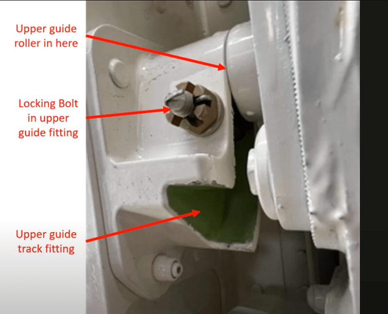

Is this senior plausible? *
1. Exit is open and ready to be closed.
2. Plug was pushed down against the springs and the top tracks and roller pins seated.
3. Two upper cross locking bolts are forgotten but the spring does not push the plug upward and out of the tracks because the stop pads are conical in the fit functions as a strong enough detent.
4. Over time the springs work the plug up leading to leaks detected 3 times.
5. Under flight pressure the stop pads instead of mating, pop past each other and the door blows out.
*Are the stop pads indeed conical to any degree?
By the way, I know of the two upper lock bolts, I hear of two lower lock bolts but have not seen them. The hinge spring over-travel arrester bolts do not lock the plug or do they? As a whole, this method of plugging the exit seems sketchy.
p.s. I like the term anti-defect used by 3DDave.

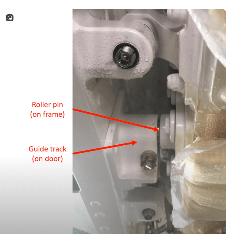

I'm pretty certain the bolts which pass radially through the green collar and hinge extension tube are the lower locking bolts, not over-travel bolts. There's a nut and washer on the end (top when closed) of the hinge extension tube, which I believe is to prevent the plug coming off the hinges when open.
New from the 737 tech YouTube channel, clarifying the design and function of the plug, and a few new details (e.g. the stop fittings on the plug have adjustable stop pins secured with lock wire):
737 Technical Aspects of AS1282 FAQs

Hi Murph9000,
Thanks, the video you linked to sends my entire contribution to rubbish bin. Good find.
Referencing this video: 737 Technical Aspects of AS1282 FAQs
If the stop pins are not adjusted correctly then pressurization loads will be taken through the guide track and roller. Given that there are stop pins and stop pads that are intended to transmit the pressurization loads, we could speculate that the guide track and roller are not designed for pressurization loads.
This might explain the reported fracture of the guide track.
Also, if the stop pins are not adjusted correctly, then pressurization will cause the plug to move outward more than intended. This would relax the gasket, possibly explaining the reported depressurization alarms in the days prior.

The more I look at this the worse I think the design is.
Depending on many variations for component dimensions and assembly variation, as the plug is moved down the interaction between the Upper Guide Roller and the Upper Guide Track might pull the plug inwards, or it might push the plug outwards.
I believe the pin bracket is adjustable, hence the use of bolts rather than rivets to fix it to the fuselage.
