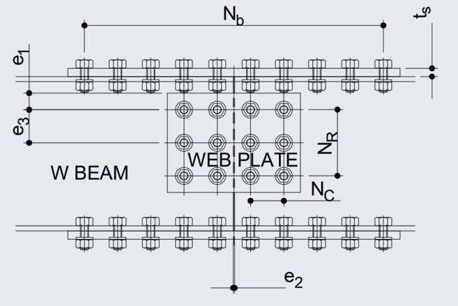

Does the AISC reduce the capacity of a tension member with bolted connections based on the length of the bolted part. For example if the tension member bolted part is 20" long compared to one that is 10" long. This might reflect the 'flow' of the load from the loaded end to the 'dead' end.
Thanks, Dik
The short answer is the "length" is the length of bolt group, not a member length.
I suspect you knew that, though, so I'd have to see a picture to provide a better answer.
Correct... my error. Something like the flange splice plates on the attached, where the length of the bolted part is about 14".
I think it's more like 30" length, but yes, in the line of force for long lengths, there's a reduction. Some of the tables have that note, maybe for the W36 beam connections?

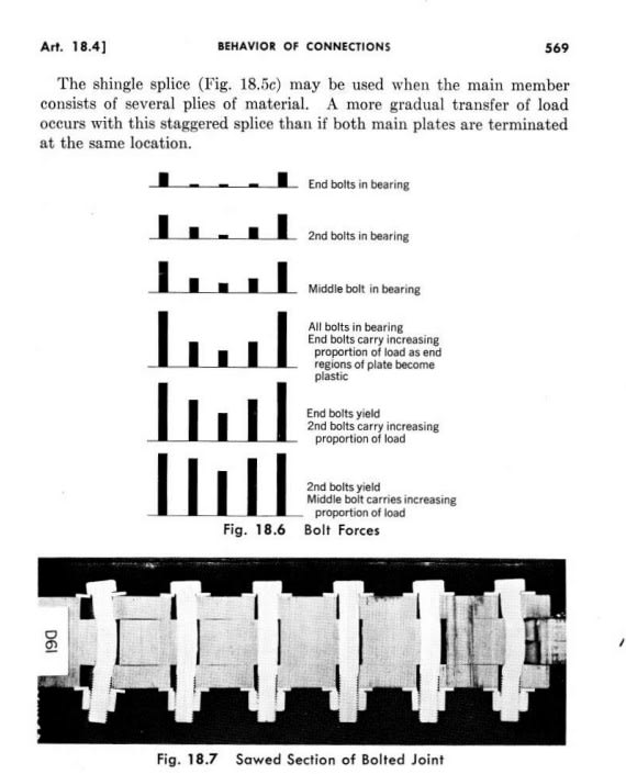

What they think happens is the lowest bolts don't see much load and the top bolt can get plastified in shear before the others see much load. If I recall Ray Tide had a good seminar on the subject when the bolt provisions were tweaked maybe 8-10 years ago. It's not the same thing as the so-called poison bolt.

This is described in Design Guide 17 Section 5.1. In this case, the length would be 4x the bolt spacing or a little shorter than Nb/2. According to the AISC Specification (16th ed.) Table J3.2 footnote c, a reduction applies if this length exceeds 38 in.
I don't think it has anything to do with the member or plate lengths.
Thanks... 14" each end. Is there a means of calculating the reduction?
It only gives one factor: 0.833.
Footnote c: "For end-loaded connections with a fastener pattern length greater than 38 in., Fnv shall be reduced to 83.3% of the tabulated values. Fastener pattern length is the maximum distance parallel to the line of force between the centerline of the bolts connecting two parts with one faying surface."

Sorry guys I can't edit my previous post, the reference is wrong. This is from Structural Steel Design, Lambert Tall, chief editor, Lynn Beedle, and Ted Galambos, Fritz Engineering Laboratory, Ronald Press Company, New York, 1964. Page 50. I scanned it downstairs then decided what book it came from upstairs, because I kind of wasn't expecting to correctly guess the scanner buttons correctly in the dark.
In my glee to upload the images, I got the references wrong on two posts in the forum.
Again, sorry.
