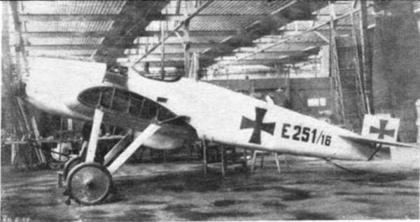

Here is a photograph of a Junkers J2, the second cantilever aircraft ever built, minus its wing.
What we tend to ignore when we discuss early monoplane airfoils, is the requirement that the wing have an efficient structural shape. This aircraft had a 120HP engine, and a gross weight of 2500lb. The contemporary Sopwith Camel with similar power weighed around 1500lb gross.
If an airfoil is grossly asymmetric like this one, you can use Bernoulli's equation to calculate lift, and get a reasonable approximation. By World War[ ]II, people had tested airfoils in wind tunnels, and they had worked out shapes that were less asymmetric, that had good lift/drag ratios, and that were not analyzable by Bernoulli's equation.
JHG
contrast the thick mainplane, with the very thin (almost planar) tailplane. Of course the tailplane generates it's lift with down incidence and with a large elevator.

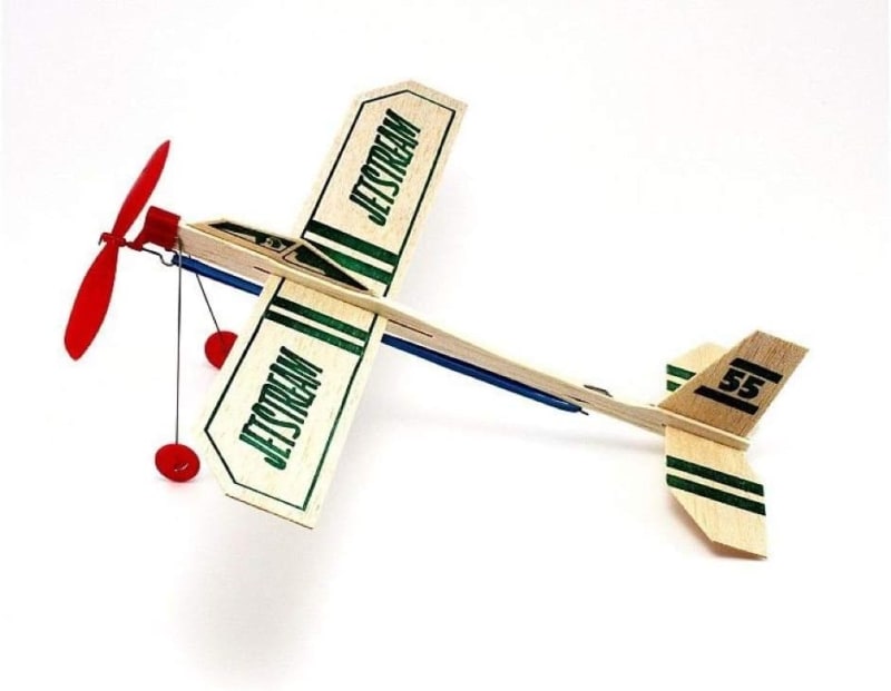

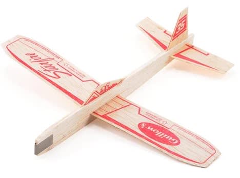

Here are the few examples of a flat-wing 'aircraft' I could conceive of... fun toys... otherwise no practical value except for teaching children.
For hundreds of reasons... aerodynamically and structures wise for instance... flat wings and stabilizers surface have ZERO practical value... for starters.
