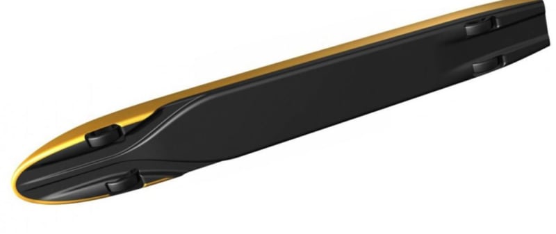

My project looks most like an salt flats land speed vehicle. The idea was borrowed from college solar cars due to the extreme reduction in drag forces while utilizing ground effect to generate the downforce needed to keep this vehicle planted at high speeds. The basic concept is "pontoons" with an airfoil suspended between them.

One element to consider for high speed vehicle drag is 'wetted area' and tapering or forward/aft blunt bodies.
The long-distance image of this vehicle implies a lot of wetted area and severe-bluntness/square-ness to the "wheel pontoons'.

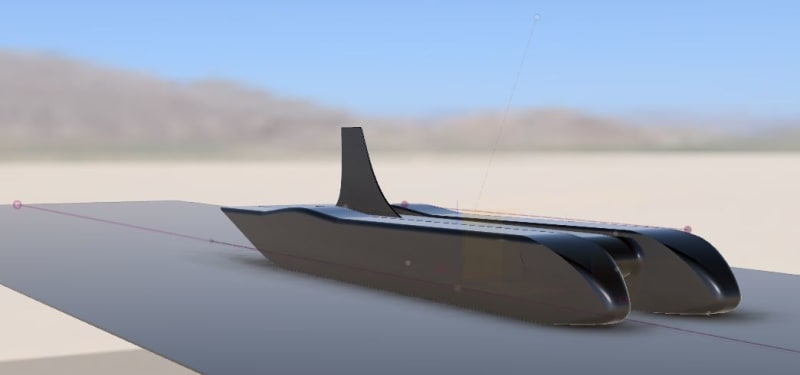

I have read about the front shape taper being a tricky thing to get correctly. The general idea/take-away I got was that a more rounded shape is safe. Setting up a sharp leading edge incorrectly could be dangerous from what I understood.
This is a better angle/view to see the shape. I am open to suggestions!

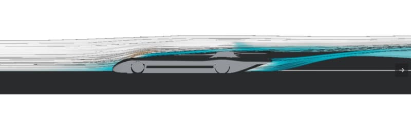

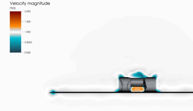

I used a free online CFD analysis, but it does not have a rolling road or specs on downforce/drag so in my eyes all I got from it was some pretty graphics with blue lines ;)
One of my largest concerns is if the downforce is balanced. If I have too much in the rear and very little in the front that could be REALLY bad!
damn that's a lot of wetted area, may well be the "cost of doing business", with all the shapes involved.
if the flow under the body is creating drag, would it help to have vents/ducts to the outside ? possibly NACA inlets on the outside ducting air into the low pressure under the body ?
@rb1957 IF that ends up being the case I may have a v2 design later to try venting out similar to what JCB Diesel did on their land speed vehicle.
If the design creates too much drag with the suspended airfoil design then I would simply build the car like everyone else has where there is a minimal air gap under the car.
