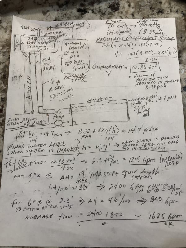

I have came up with a possible solution thinking out the box. I think it may work to provide a quick vacuum and it is rather simple without any mechanical equipment except a small pump to fill the system. May need some tweaking and calculation/sanity check lol.
In the attached sketch water is filled up to top of elevated tank using a small GPM/Head pump from an atmospheric small volume storage/discharge tank while venting. Vent is closed and quarter turn valve such as butterfly is opened. Liquid level rapidly falls to evacuate the elevated tank until it reaches a height of 14.7 feet where tank is completely evacuated in about 4 seconds. 14.7 feet is level that P vacuum + Gamma*H/144 = 14.7 psia. Vent pipe and riser pipe are sized for maximum anticipated flowrate. Repeat steps for each subsequent cycle.

And yes I lack appreciation for exponential decay and other fundamentals.
I assume you meant water ring pump. Note that water vapor pressure @ 30°C is 0.6 psi. This means you have dP 1.0-0.6 =< 0.5 psi for vacuum suction system and desgn margin <5°C for water operating temperature. Challenging to achieve such in reality.
