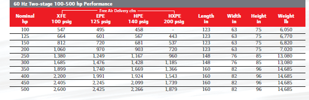

OK,
It looks like you have a SSR EPE350-2S screw compressor. Search on that code and you might find something more - or just call IR direct....
This table at 60htz and 140 psig for the 350hp machine matches your quote above.
The FAD at 100 psig is 1899 cfm so two is in theory 3798 cfm, not far from your requirement of 3866.
But they are operating flat out.
