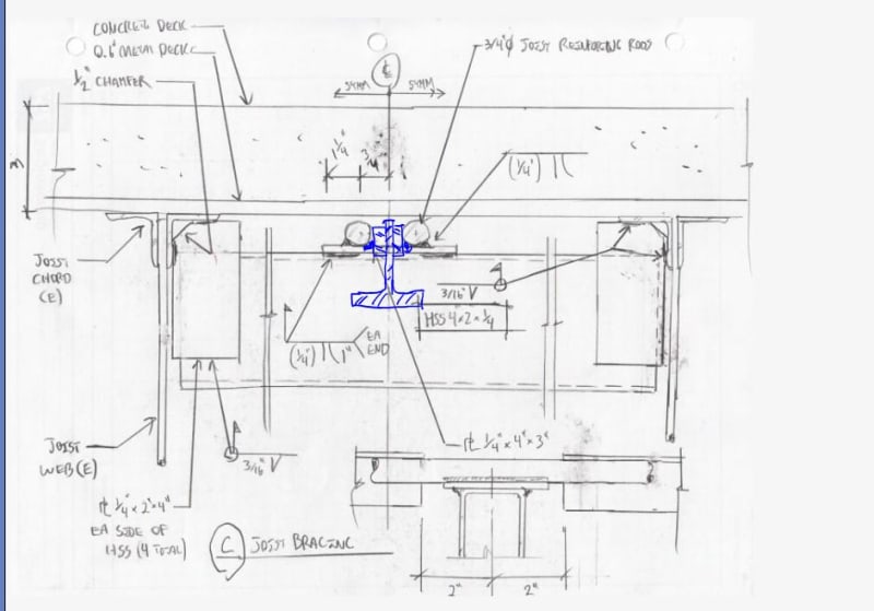

A steel joist on one of my projects found itself on the losing end of some plumbing work. We'd originally wanted the joist supplier to tend to the repair but their opinion was that a joist this badly damaged couldn't be repaired. Since I've gone and attempted to repair it anyhow, I thought that it would be beneficial to post the scheme here for critique. See attached PDF, replicated below. Some deets:
- 24' long
- 3" non-composite slab above
- 14" deep
- Uncommonly tight, 32" joist spacing
- Residential floor space above
- No new capacity required. Simply the reinstatement of the original capacity.
- Existing chords are 1.5" x 1.5" x 0.125" angles.
- Existing webs are 1/2" dia rods
- Panel point spacing = 24" classic.
It's tempting to explain my rationale here but:
1) Much of it should be self evident (I hope) and;
2) I don't want to taint the critique with a bunch of upfront "selling".

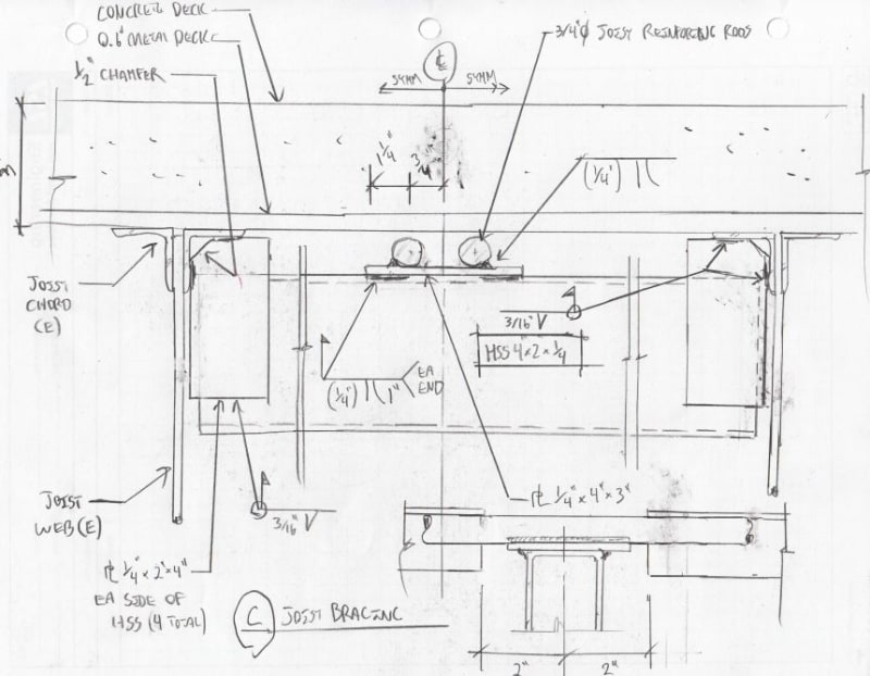

Damn it.. just realized detail C is not going to fly geometrically.
While one is up there with a welder, how about incorporating the decking to the upper chord with welds there also.? Belt and suspenders.
Thanks! Also, wow! Did the coring bit operator fall asleep or something? I've run one of them before and it's really obvious when you're cutting through steel and not concrete.

My first thought is that epoxying overhead is difficult even with proper training. I'd swap those out for a screw anchor from your favorite flavor of supplier.
The other thought is have you actually lost camber? I would hazard a guess that the truss being screwed to the metal deck is limiting deflections in the truss at least enough that you simply need to shore up the truss while welding but not actually jack it up any further.

Maybe I've missed the solution.....but what bothers me the most with this is doing this welding to the chord when it is already missing a portion. Is there a shoring/bracing plan for this while this work is happening?
I explored that a little. Wanted Kwik - HUS. Not many good anchors that would yield a suitable embedment depth while also accommodating the standoff dimension. I'm saving asses here. If somebody has to be blinded by a little dripping epoxy adhesive to get it done, so be it. Amenhotep wouldn't have been bothered.

Revised detail C.

Jack/ shore it up to compensate deflection, safety during repair and to reload joist effectively, Why not weld 2x2x1/4" angles for the damaged portion of the joist plus 6" longer each side on both sides ?
1) Weld access seemed like a problem unless I went with end welds. Usually I avoid transverse end welds in loaded things but, here, perhaps that wouldn't be a problem.
2) Angle in angle scenario creates an interference between the new angle heel and the existing angle fillet does it not? I thought about doing something similar with bent plate but I wasn't convinced that a 2x2 bent plate was a practical thing to request.

Square bars in lieu of round bars for the webs may give better access to the welds.
I like it. Probably more reliable welds than the flare bevel too. Presumably, this kind of material is commonly stocked for architectural metal stuff.
celt83 said:
could you do a inverted WT slotted between the top chord angles then provide spacers for the attachment of your chord bars?
I could, at least between existing panel points. What benefit do you see the tee providing? You seem to be proposing it in addition to the rounds rather than instead of them.
