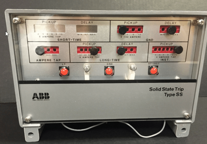

Here is an example of a Solid State trip unit on a breaker. The settings are changed by moving the pins on the front. Not sure if you are referring to something different.
