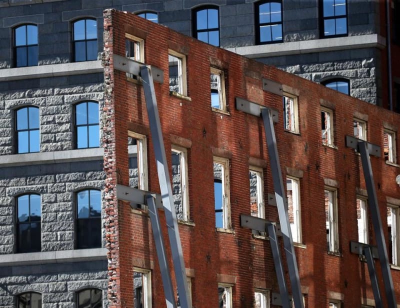

heres pic of the structure:
thanks

You forgot to mention it was on sloping ground.
More importantly, what can you potentially do to create foundations strong enough to support another 8 floors without causing the existing structure to collapse?
You need to think of this structure as simply a bunch of stones sitting on the ground maybe 300mm below ground level held together by gravity alone.
It's either a total re-build carefully marking each stone in its current position or building some sort of internal or external skeleton around the existing structure and somehow creating a separate set of foundations to make sure the building is still standing when you finish.

When you mention interior arches, are you talking about a masonry vaulted arch roof? I'd suggest that you don't puncture this roof with new columns. As others have suggested, your best option may be a dramatic exoskeleton or a stone-by-stone reconstruction of the existing building within a new structure.

Years ago, they renovated McGraw Hall on the Cornell Arts Quad. As noted above, they left the facade and built new behind if my memory serves me right. I'd not even think of putting 8 stories on the existing structure wall. Side question - what would the new 8 stories look like - keep the "culture" or look "new"?
