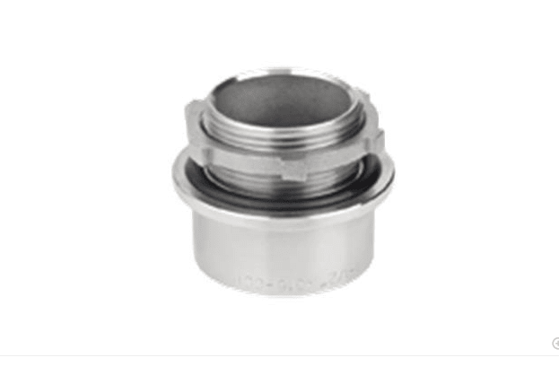

I suggest using sealing hubs to enter the enclosure.These are known in the trade as Meyers Hubs or Bullet Hubs.
They will provide a rain-tight conduit entry.
It goes without saying that all the hardware must be rain-tight.
You may need to provide mechanical protection around the conduits and LBs.
Rigid conduit (either steel or PVC) is often accepted as inherently self protecting, but there are exceptions.
Conduits in or near vehicular areas may need extra protection even for rigid steel conduits.
Bottom line;
Rain-tight and suitably mechanically protected.
Note the "O" ring to seal against the enclosure.
This is a standard feature of Meyers Hubs.
They are available in:
Die Cast, (Zinc)
Aluminum
Steel
Malleable Iron
Stainless Steel. (Shown)
