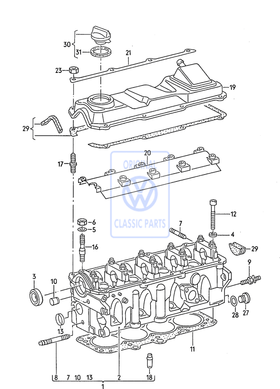

If the problem is just the cover bowing then a simple fix could be to make something like part 21 to apply more even pressure between the bolts.
Two lengths of flat bar with holes either end that attach to the outside of the cover with the bolts would do.
Excellent idea LL!

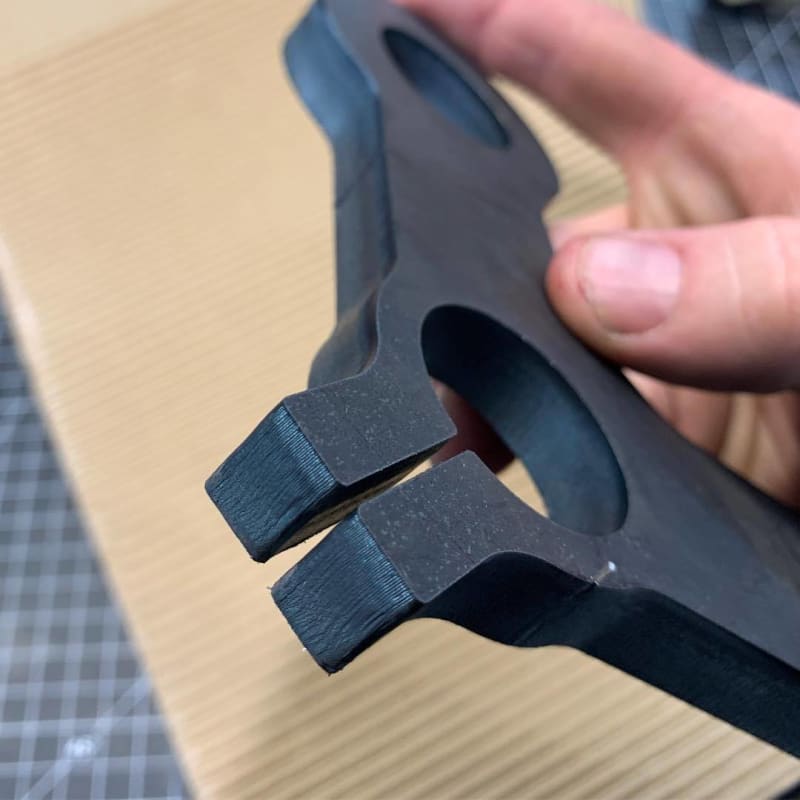

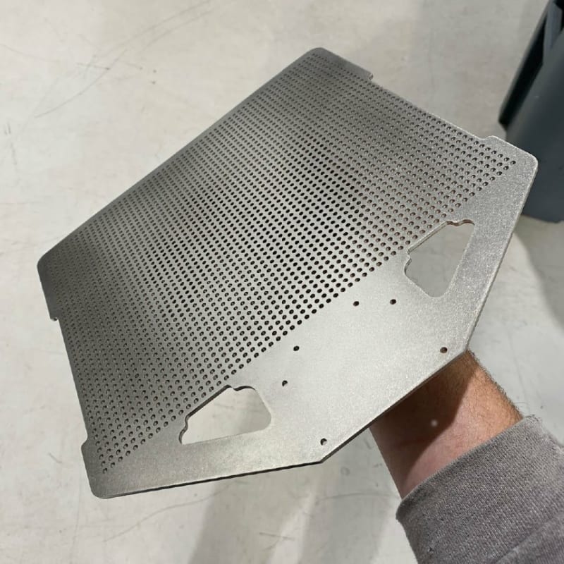

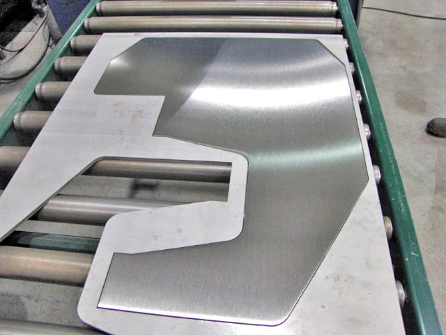

sendcutsend is a custom laser cutter with crazy reasonable prices! I get stuff cut there for less than I can get plain rectangular sheets cut to size. They can cut you stainless, copper, brass, cold-rolled, hot-rolled, titanium, the list goes on and on.
You provide a drawing in any of a dozen formats and the common ones will auto quote you online. Less common drawing formats they get back to you.
You could draw a stiffener as LL631 suggests (#21 above) that is the entire perimeter of your cover as wide as it can be and drop it on top of the cover and screw the original bolts thru it. The laser cut would, of course, include the existing holes. Use 1/8" stainless or even thicker if desired.
Alternatively dump the idiot cover entirely and replace it with a stainless plate that can't bow.
Examples:
0.125" SS
0.5" Cold rolled
SS
