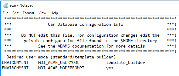

my very important question is that i can't get into template builder in adams/car .
the option to choose standard interface or ttemplate builder does not appear at the welcome ...
does template builder need any special access ????
if not , how can i use it ???
thank you very much
i'm using msc adams 2018 and I have looked through all over adams/car for it …
I have read help menus , looked all over Tools menu and also I know ,as it is said in help pdfs, that I must be able to change mode from standard interface to template builder from Tools menu , I have also tried database management but not single clue ...
 https://files.engineering.com/getfile.aspx?folder=69774496-4003-4aa4-8d02-2d1c87b4f041&file=Adams_Car_Adams_2018_3_6_2019_11_15_59_AM.png
Hi bj7777,
Well, the solution for your issue is to following the next steps :
1. search after acar folder and open it,
2. search after acar file and open it with Notepad (acar file is a .cfg file),
3. modify the acar.cfg file : !ENVIRONMENT MDI_ACAR_USERMODE template_builder .
4. save the update and close the file.

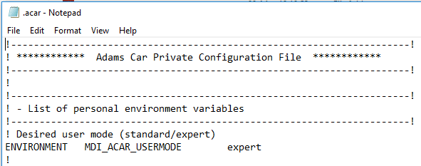

5. now search after .acar.cfg in your Windows User folder (something like "C:\User\...\.acar.cfg"),
6. open the file .acar.cfg and modify it as : ENVIRONMENT MDI_ACAR_USERMODE expert .
7. save the update and close the file.
8. reopen ADAMS Car.
Regards,
Daniel
