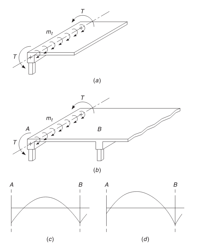

Please see the example image below (taken from Design of Concrete Structures 15th Edition, Darwin, Dolan, Nilson). Note, this is not my particular scenario but I need to first establish the general theory before we look at my specific case.
The perimeter (spandrel) beam at the slab edge attracts torsion due to the slab edge's unresolved negative moment (moment diagram shown in Section C). If we allow cracking to occur the moment redistributes itself, in this case larger positive mid span moment within the slab.
Question #1: Is the relief in moment due to cracking of the spandrel at it's ends, rendering the entire beam to be torsionally flexible? Or is it a local crack at the interface between the slab edge and the spandrel?
For this situation, compatibility torsion looks acceptable because the slab has more than one way to permeate flexure through the system.
Is my understanding correct that Tu is the resultant torsion that acts over the entire span of the spandrel beam? IE, we don't need to calculate any local (1 ft strip) version of Tu to first check the local interaction between the slab and the spandrel beam?
Now, if Tu ≥ ΦTcr, and Tu can be reduced via moment redistribution, the Code permits us to reduce the Tu value down to ΦTcr in accordance with ACI 318-14, Section 22.7.5.
Question #2: If I compare the original Tu, calculated from the original analysis, and Tu < ΦTth, then I may neglect all torsional effects?
Question #3: If the original Tu > ΦTth, but I allow a reduction of Tu to ΦTcr, then I need to design shear reinforcing for ΦTcr which is essentially 4x the threshold torsion for solid non-prestressed cross sections?
Question #4: What is the simplest way to determine the higher demand on the slab's positive moment due to reduction of stiffness at the perimeter beam?

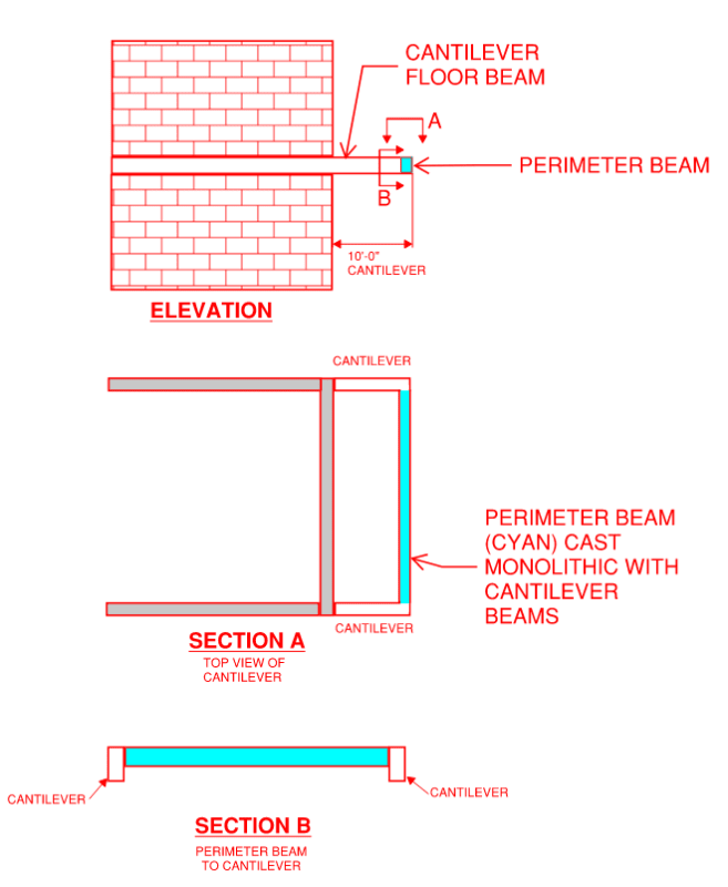

Please see the image below for my actual condition:
KootK said:
How close will your perimeter beams be to your columns? What are the proportions of your girders and joists
I basically have a perimeter beam that cantilevers out and has a perimeter beam cast monolithic with each end.
I'd like the loading from the cyan portion to provide (1) shear reaction at each end of the cantilevers. I don't want to impart negative moment to the ends of the cantilever.
Based on the above sections, my plan is to:
1. Determine the simple span moment and shear from the cyan part of the beam.
2. Apply shear reactions from #1 in addition to the ledger load acting along the cantilever. I would then calculate Vu and Tu at the interface between the cantilever and the supporting wall (the total loading for the full 10 ft cantilever).
Please confirm the Tu will be checked at the support of the cantilever beam and not the interface between the cyan and cantilever.
3. If Tu < ΦTth, then I may neglect all torsional effects.
4. If Tu > ΦTth, then I must consider torsional reinforcing and I can set Tu to ΦTcr.
5. From the combination of Tu and Vu, I can determine the torsion reinforcing in the beam.
6. In addition, at the interface between the cyan and the cantilever, I'd will provide hanger reinforcing per ACI 314-14.

OP said:
Looking at this again, I believe I'd need to maintain Equilibrium Torsion for this cantilever girder. Allowing it to crack in order to re-distribute moment seems like it could create a failure mechanism.
I disagree, this approach is ubiquitous in RC concrete. I would also say that your cantilever span is long enough for this to be sensible.
That's right. Tu is your peak torsion which usually occurs at the supports.
OP said:
The other issue I'm up against is how to rationalize the end moments of the joist. It will impart a moment somewhere between 0 and wL²/12 at the cantilever girder.
Design it as simple span while providing "detailing" top steel at the ends providing a negative flexural capacity 1/2 - 1/3 of the midspan positive flexural capacity.
