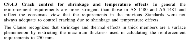

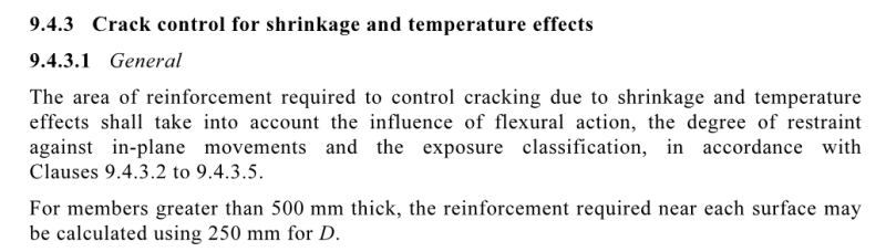

I did a few thick pads (1.2m thick or so) for large transformers in switch yards in Australia in my early days (15+ years ago), they used to have some provisions (and may well still have) that limited the concrete depth you considered to be something like 250mm from the free face for applying temp and shrinkage provisions. So if you had 500mm thickness, you considered the whole thing, but for 1.2m you considered 500mm thickness, considering each face separately at 250mm. This was the provisions from older version of AS3600, someone might be able to confirm if its still there in later versions and what it is based on, following on from this there was some further equations based on D:-
EDIT:-
found my commentary which explains the thinking behind the limit:-
