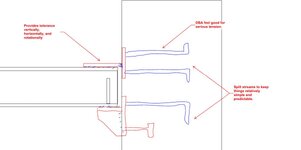

For something where the stakes are high like this, I would favor an old school, "pre-Profis" connection with some built in ductility. You sell it on the merits of the tolerance argument and, perhaps, by appealing to the architect on the basis of "what tends to resonate with a lay person as structurally appropriate".

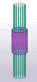

Thinking about this some more for some odd reason. I suspect what might have been detailed look like what I have below. That is a standard column with a magic steel piece miraculaously placed in the middle. Easy to draw, difficult to construct.
If I were looking at this I would suggest something like below. Your client could easily weld starter bars to your pipe and if the rod busters stop their cage below your assembly, it will fit inside their cage. You could even add some Koot bearing plates to help if you want. Ideally they would cast the column to the top of your assembly and complete after. The benefit of that is your crew can likely add some of the moment connection plates for the outriggers in the shop and use that to get this assembly perfectly braced before casting. This assembly could be around 1500lb, so bracing will be important. If they will not allow a two pour, this still possible, but far more prone to movements during the pour since it will fit inside some type of form.

I like the steel column idea but if that's not possible how about have a composite connection like the snapshot below if the column diameter permits. If you can recommend increasing column diameter just for connection purposes too, that works.
