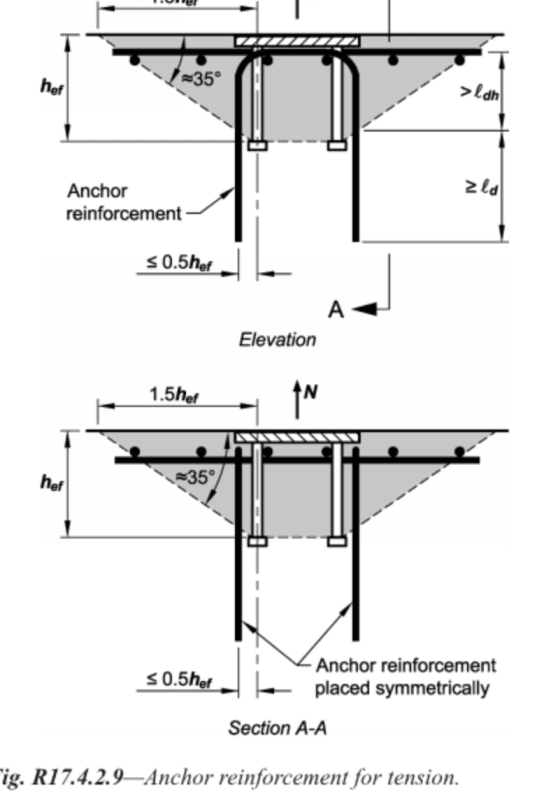

I am looking at the concrete pedestal reinforcement in seismic zone D for uplift on a column base plate. The commentary on ACI 17.5.2.1 states that research for allowing you to use the design strength of the anchor reinforcement instead of designing for concrete breakout strength was based on was or limited to anchor reinforcement with a maximum diameter of a #5 bar. Can you use something larger than a #5 bar as long as you meet the requirements in chapter 25 or is it better to keep the tension bars (I will be using U shaped bars) at #5 and then add more bars? I would need around (10) #5 bars instead of (5) #7 bars when using option D (17.10.5.3) and applying the overstrength factor to Eh. If I understand correctly all 10 bars would have to be within the .5hf (which would be 9" in my case for anchor bolts with 18" embed.) I also have a shear lug so placement of the reinforcement might get difficult. The pedestal is 24"X48" and it is 4' to 7' tall depending on the location in the wall.
Thanks for any thoughts or help in understanding this.
My understanding of tension reinforcement in this situation is that you have three paths available:
1) Anchorage per ACI 17.5.2.1. If this is your path then I do feel that you should stick with the #5 bars to be consistent with testing. I consider this path to be "Enhanced Anchorage" rather than true reinforced concrete design. Obviously, extending supplemental reinforcing beyond the failure frustum only engages a bigger failure frustum, it doesn't guarantee a complete load path to ground.
2) AISC's version of anchorage as described in their Design Guide 1 - Base Plate and Anchor Rod Design. Follow their limits as described in the design guide if taking this path.
3) Abandon ACI anchorage in favor of something more resembling true reinforced concrete design principles. The paper on this by Widianto is an exemplary resource: Link. Use whatever size reinforcing you like so long as the math checks out.
For something on a larger scale, as your problem seems to be, I would favor the second and third paths.
The code refs seem to be slightly different from my copy of ACI 318-14, maybe you're using ACI318-19, but it appears to me you are asking about tension anchor reinforcement specifically, not shear anchor reinforcement.
Two issues I see are first, you are explicitly using a larger size bar than is validated by research per the code commentary. I don't think this is a deal breaker, as it is stated in the code in the commentary, it is more of a recommendation/note to the user. However, you may not want to get too far away in size as a precaution.
Issue number two, once you increase beyond a #5 bar, the development length needed (ldh for your U-Bar) can cause excessive anchorage embedment requirements since you need to develop the anchor reinforcement above the assumed failure plane at the anchor head/welded nut. This may not be an issue for you since your pedestal sounds like it will be quite tall.

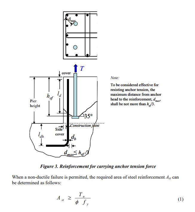

Taking a quick look at the paper KootK linked, the STM methods described there seem to address shear anchor reinforcement more than the tension anchor reinforcement, which seems to follow the ACI318 guidelines.
It also specifically says the following: "In order to limit the embedment depth of the anchor, a larger number of smaller-size reinforcing bars is preferred over fewer, larger-size reinforcing bars" and "Reduction in the development length cannot be applied in the areas of moderate and high seismic risk".
If it were me, I'd try to make #5s work with the layout you need for your shear lug, or maybe bump to #6s if needed.

This is the part of the Widianto paper that covers tension. I'd be looking at that as, effectively, a sort of non-contact lap splice similar to the second clip below.

ACI318-14 17.4.2.9 is very similar with slightly different values and cites a different paper:
I suppose that it comes down to what one considers to be "similar". My understanding is that ACI318-14 17.4.2.9 is still, fundamentally, relying on the tensile strength of concrete for overall tension resistance. That, in contrast to Widianto and the AISC design guide which approach the problem as a non-contact lap splice after a fashion. That's what I've been viewing as the primary dissimilarity here.
Interesting KootK...I don't see any reference in either ACI318-11 or 318-14 to that larger frustrum of breakout and concrete in tension when anchor reinforcement is provided. Do you have any publications you can share that describe that?
To me, the code states pretty clearly that you don't perform a frustrum check for breakout, but instead replace that with an anchor reinforcement check to be based on the yield strength of the rebar assuming it is developed above and below the failure plane, but using 0.75 instead of the usual 0.9 phi factor. So 0.75*fy*As.
That seems similar to a noncontact lap splice and similar to what Widianto describes.

To me, it seems that ACI leaves us to make one of two assumptions:
1) They are implying that the force developed in the anchor reinforcement is meant to be passed to other reinforcement via standard RC design principals, despite not explicitly saying that OR;
2) They are implying that the force developed in the anchor reinforcement is meant to be passed to another, usually much larger, concrete frustum in tension beyond the originally assumed failure plane.
My feeling is that #2 is ACI's intent.

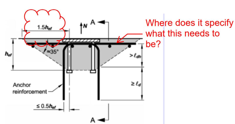

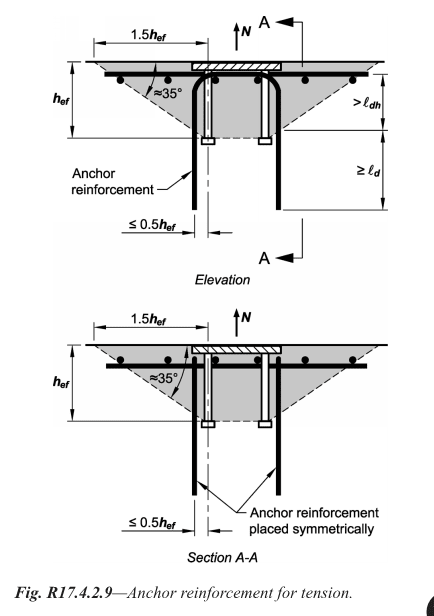

A couple questions about Figure R17.4.2.9 I have can get the ld and ldh but it shows the breakout at 1.5hef My understanding is that I don't have to check that or meet 1.5hef because I am replacing that requirement with an anchor reinforcement check. Am I reading that correctly? See attached picture
Also, I am using the shear lug to take the shear force. I will include ties but ACI 17 doesn't state that I necessarily need to. Is it good practice to include the ties anyway?
I believe they are showing the concrete breakout failure surface in that image to illustrate the development length requirement above and below the failure plane when you use anchor reinforcement. So, no, you would not need 1.5 hef minimum width, however, you will want to sketch out that projected failure plane to determine if you have adequate ldh above the intersection point when you are laying out your anchor reinforcement.
Think about your load path, adding the shear lug removes the shear from the anchors, but you still need to check your concrete breakout based on the breakout frustum of your shear lug in the concrete. If you can't meet the breakout strength requirement, you'd need to provide ties and size them as needed. Can't hurt to provide them as long as there aren't clearance/install issues. Nice peace of mind for a few small diameter ties.

Thanks- just wanted to make sure I wasn't missing something.

...I don't have to check that or meet 1.5hef because I am replacing that requirement with an anchor reinforcement check. Am I reading that correctly?
I agree with your and structbell's opinions that this becomes moot with the tension reinforcement in play other than as a guide to know if you've got enough room for development.

1. With the 2 U bars shown below on ACI, would that count as 4x Astxfy or 2x Ast x fy for tension capacity?
2. Can I just provide sufficient tension reo on one side of the failure plane (not both sides symmetrically).
3. Instead of U bars, can we use straight bars in the top matt (perpendicular to bolts) that are developed beyond the failure zone. The load I assume would be N*/Tan35
