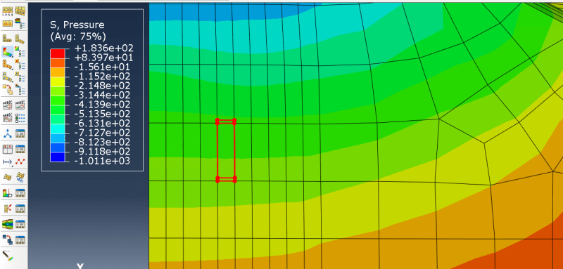

I did some test simulations, and I got for example this element:
So the pressure values on this element range from -260 to -393 MPa if you look at the nodal values (see the legend), but if I extract the pressure values on the integration points, they only range from -323.9 to -323.3. This will give a huge difference in gradient!
For reference, this is the position of the element within my assembly. For a real model, I will make the elements smaller and the nodal values will be closer to the integration point variables, but still, the difference here is immense!
That's why I would prefer to use the nodal stress value, as I think they will provide me more accurate information when calculating the pressure gradient.

EDIT: I checked with a finer elements, and the problem is still the same.
