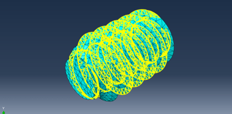

Im trying to mesh the geometry below with just one type of mesh (i.e. no free mesh). At the moment I have made partial progress by partitioning the instance with some datum planes (as shown by the regions highlighted in yellow, as opposed to orange where mesh cannot be assigned), but I'm still not able to mesh the whole thing. Would be highly grateful if anyone could shed light on how to do it!
If this thread can’t be simplified for the analysis, it won’t be easy to mesh it. But partitions are key to the success. You need a lot more of them (they should divide the geometry into the simplest possible shapes). However in this case partitions may not be enough and you might have to use virtual topology feature. Even if you fail to mesh this part with hexahedral elements, good quality second order tets should give you accurate results as well.
Thanks for the speedy reply. The reason I want to mesh it with a single mesh type is because I need to import it into Paraview, which requires one configuration file per mesh type and so a single mesh type would be very handy. I've tried virtual topology but still cant figure out a systematic way to mesh the whole structure.
I think this part cannot be fully hex meshed. At the start and the end of the thread you'll always have a problem. If you don't want to mix elements, then you have to go with tets.
Try to separate thread segments using partitions. Datum planes aren’t the only option, you can use other techniques such as extend face or extrude/sweep edges as well. If this approach doesn’t work (and that might be the case) then either simplify the thread (Replace faces tool can help) or use tetrahedral elements for the whole part.
I tried meshing the whole part with tets but the elements in the thread part are severely distorted and the following error pops up:

Any idea how to resolve it? I also tried to refine the meshes but no luck!
In case of such complex geometry free meshing with tets is not as easy as it could seem. Proper partitioning and virtual topology may be required in this case as well in order to obtain good quality mesh. If you can share your model here then I will take a look at it and try to tell you how to mesh it with tets.
Abaqus was able to mesh this part using tets even without any changes. But you can use Virtual Topology —> Combine faces to combine some small faces in order to obtain better quality mesh.
Some elements are still distorted when I inspect it using 'verify mesh' (highlighted in yellow in the image below), and when I merge the small faces abaqus takes ages to mesh. Do you get the same distortion if you verify the mesh?
It seems that you should reduce the global size. Assigning local seeds may also help.
Sure, I used 0.4 for the global size and it seems sufficient.
Thats what mine looks like with 0.4. There are still 35 distorted elements, wondering if they matter in the analysis?
No need to worry about that. There are pretty much always some elements showing warnings (highlighted in yellow) with default mesh verification settings in Abaqus.
