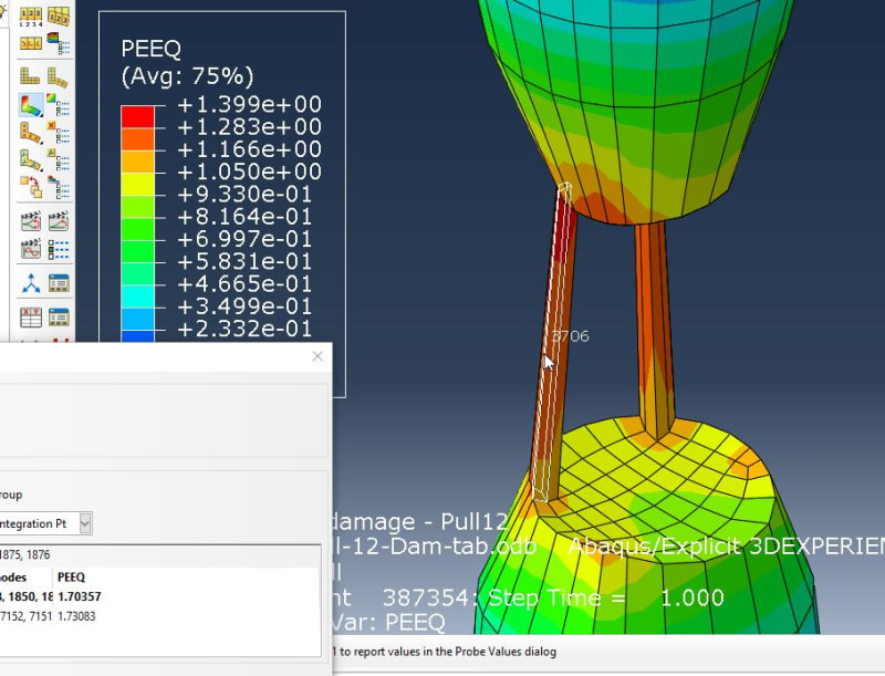

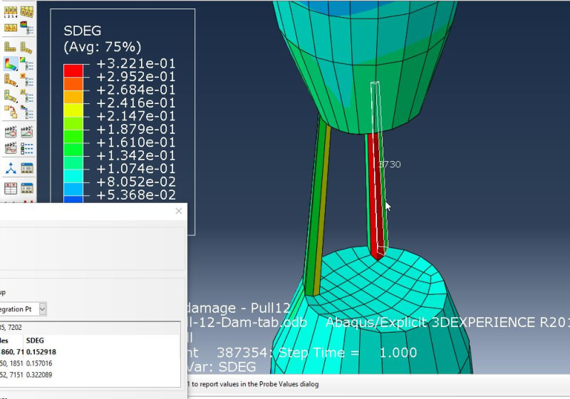

Another point - why have these elements not failed - PEEQ of 1.73 meaning the elements are 5.6-times longer than originally (the following view is NOT scaled!).
But the degradation is only between 0.15 and 0.32 - how does this happen?
Triax value of these elements is between 1 and 2.1.
ER (change rate of strain) is as high as 6.6 .
But these values are well covered by damage initiation criteria.
Ductile damage initiation
0.15 -0.3 0.1
0.15 5 0.1
0.15 -0.3 300
0.15 5 300
How does this fit together?? I have no idea why these elements are so slightly damaged.
